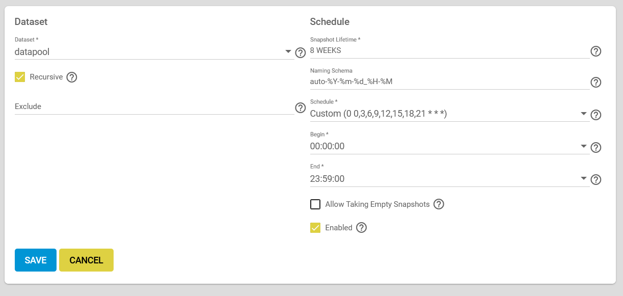

yesterday afternoon I activated the shown task for automatic snapshots of my main Pool "datapool" (yes, silly name. :wink: ). Its the only snapshot-task.
So, the system should take snapshots every three hours (from the Pool itself and the child datasets), but only if there are changes.

The "Allow Taking Empty Snapshots"-option in the snapshot-task is not set.
