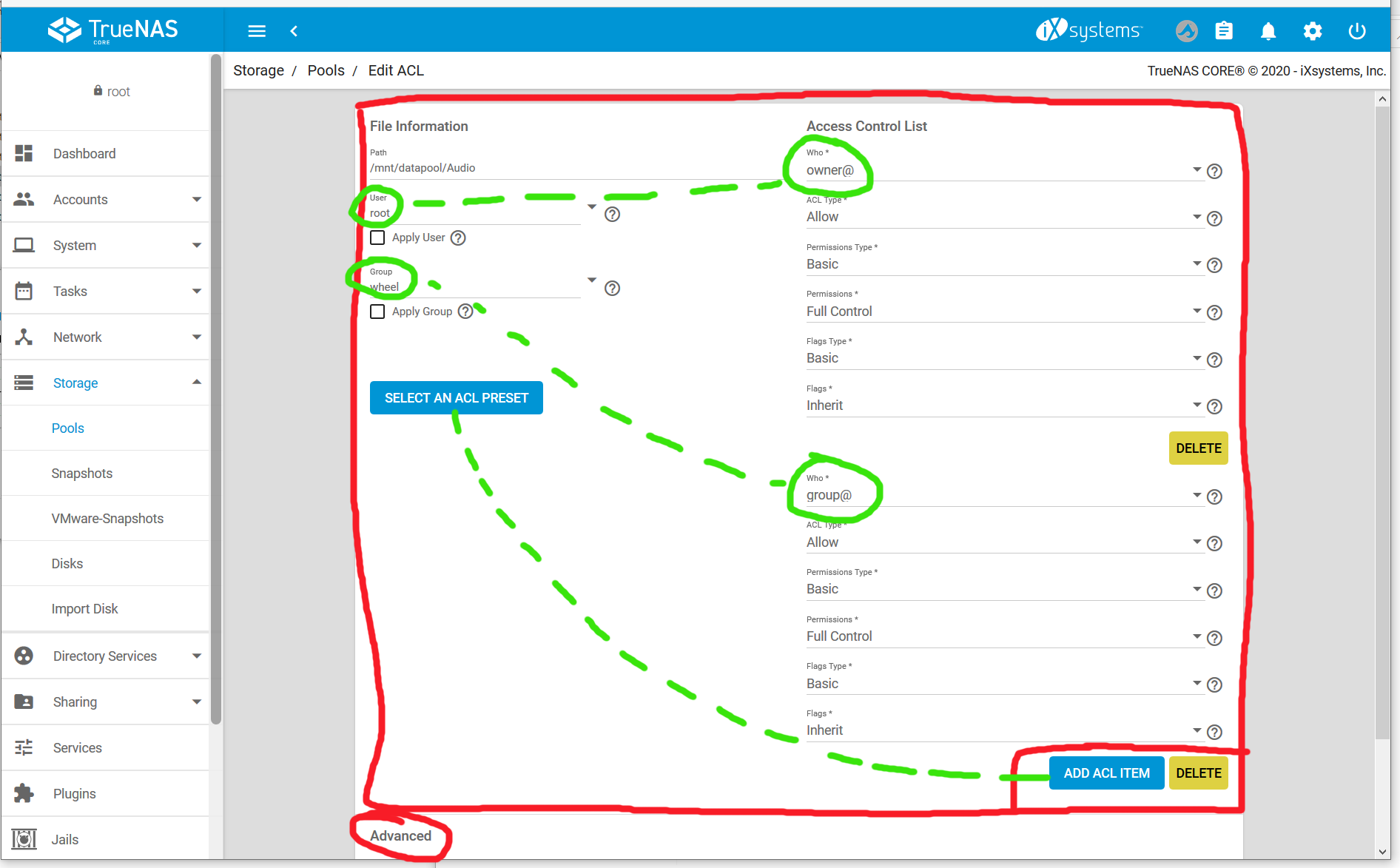

And it seems there is no clear distinction between adding an ACL and adding an ACE for an ACL.
I want to give more feedback about this topic because I gave TrueNAS a 2nd (and 3rd) chance this weekend (because I really like the TRUENAS-MINI-3.0-X+) and experimented a lot and I managed somehow to add users that can access SMB shares. I still do not know if its the best way how I did it. etc.
So I want to share one of my main obstacles adding ACLs because, in my opinion, everyone already knowing TrueNAS has probably already internalized this strange UI-behaviour.
Preface:
Users have expectations about a UI based on their past experiences. So a lot of users that have already used a computer for entering data (addresses, customers, users, products, etc.) expect more or less some CRUD (create, read, update, delete) functionality for data records.
So, when I clicked "Edit Filesystem ACL" after creating a new share (which seems to be the same as "Edit Permission" for a pool), I expected to get a form/page where I can create/add an ACL itself and after I created a new ACL I expected to be able to create (CRUD) the entries/members of that ACL (the ACE records).
With this expectation, I got the following page. I have drawn in green and red how I saw that page/form:
The word "User" on the left side connects to the "owner@" on the right side, the word "Group" on the left side connects to the word "group@" on the right side. So all these input fields are optically part of one form (I marked the form with a red border) and one ACL-entry/record.
And because the buttons "SELECT AN ACL PRESET" and "ADD ACL ITEM" look the same and are below the data fields (in their column) they are both doing something for the ACL-data-record. Then "ADD ACL ITEM" clearly (it is at the bottom, like form-buttons usually are) will mean that this button ADD/Create the ACL-record with the input fields above.
It surely does not help for understanding this form, that the form-scrollbar is detached from the form and sits at the right border of the browser-window and that the real "SAVE" button is below the screen horizon and is not visible on screen without scrolling. And I do not have a small screen resolution.
Later I understood, that this one form includes the fields for the ACL itself but also all data-records of its members/entries (ACEs) and that all ACEs are shown in the right column with all their data-fields.
But then my expectation was, that the buttons "ADD ACL ITEM" and "DELETE" are related to the fields/data-record above them (like it is in a typical html form).
It did took some time to realize that the "ADD ACL ITEM" button is completely at the wrong position because it is not related to the data above (like the DELETE-button that is next to it) but adds a new, empty ACE-record that is not saved until I scrolled down and clicked the "SAVE"-button.
And I still do not understand why there is a "CANCEL" button besides the "SAVE" button if the form-data is only saved after pressing the "SAVE" button.
I think this is an example of bad UI design and the UI should be changed. But as long as the UI is not changed (there are probably good reasons for not changing the UI) it is an issue that should be included in the documentation, so new users do not fall easily into this trap (like I did).
P.S. If there is a more appropriate area in the forum for this kind of discussion, please give me a hint.
P.P.S. There are a lot of places where the "action-icons" (i.e. the three dots that open extra masks, functions etc.) are hidden because they are not seen without scrolling because they are in the right column of lists. Thats also an UI-issue that should be explained in the documentation.

FreeBSD has native NFSv4 ACLs. They can be set on any file / directory. Newly created files/directories inherit their ACL from the parent directory. The SMB form has a convenience feature to click on a button to edit the filesystem (ZFS) ACL of the share path. This can be important for end-users who are sharing a subdirectory inside a ZFS dataset (because its ACL may be different than that of the dataset itself).
Why are this different ways existing? Whats the best way of setting up permissions if there are only SMB-shares used on the NAS? Does it matter in this case if an ACL is setup as "filesystem" or "share" and can both setups do the exact same thing?
A "share" ACL is a somewhat different beast. These exist on Windows as well, which is why there are separate tabs for them in "computer management" on a windows server. They go back to the days before NTFS, and are not on the filesystem itself. Samba stores these in share_info.tdb. The reason to have this is if you decide to eschew the native NFSv4 ACLs for some reason, you can still use the Share ACL to define permissions via the SMB protocol. These permissions are share-wide and have same behavior as on windows. Filesystem ACLs are on the actual file in question and are enforced by the kernel / filesystem.
Where are all the fields and their possible data values and the consequences of values explained in detail? Is there an easy way to see all ACLs and ACE (ACL entries) in one place at a glance? And it seems there is no clear distinction between adding an ACL and adding an ACE for an ACL.
Files /directories always have an ACL. The difference in this case is whether the ACL can be expressed as a POSIX mode without losing information. If a file can be expressed as a POSIX mode without losing information, then the "permissions" editor is unlocked and available for use. Otherwise, the ACL editor is presented. Presenting all the ACLs on a dataset's contents in one glance is not really possible because if you have 100K files, then you would have 100K separate ACLs.
In versions prior to 11.3 SMB users were always using these ACLs, but they were not exposed in any form through the GUI. This meant that users had no effective means of auditing /altering the on-disk permissions on their server other than using a windows client. If vfs_zfsacl is enabled on a server whether vanilla FreeBSD or TrueNAS, a client with sufficient access to the server can alter the filesystem ACLs (this is part of the SMB protocol).
