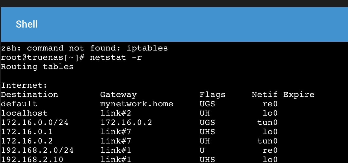

- I can however connect to the TrueNAS Web GUI on 192.168.1.1, then open a SHELL prompt and able to ping 192.168.20.x devices.

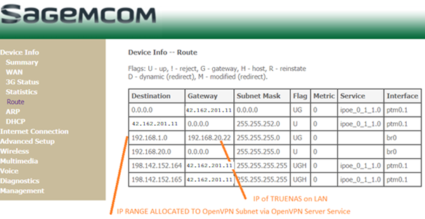

My LAN

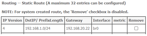

Default Gateway: 192.168.20.250 (This is my Internet Router – Sagecom Modem)
Mask: 255.255.255.0
DNS servers: 192.168.20.250
TrueNAS: 192.168.20.22

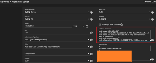

My OpenVPN SERVER configuration

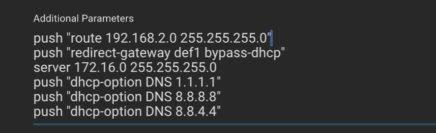

The additional parameters added as follows : (as suggested in the other post)
push "route 0.0.0.0 0.0.0.0"
push "route 192.168.1.0 255.255.255.0" # My OpenVPN transfer net
push "route 192.168.20.0 255.255.255.0" # My remote network I want to connect to
push "redirect-gateway def1"
push "dhcp-option DNS 192.168.20.250" # The DNS Server on my remote network (my Optus Modem)
Tunable (TrueNAS has been rebooted)

Static Route Entered on my Internet Modem (Sagecom) = 192.168.20.250 (LAN)
(Showing the Route Table on the Modem
RESULTS
With the VPN Established on the Client PC via iPhone HotSpot.
I can ping : 192.168.1.1
I can ping : 192.168.20.22
I can access services on the TrueNAS box : \\192.168.20.22\xxx
I still CANNOT access anything outside the NAS IP : 192.168.20.22.
Cannot ping 192.168.20.250 or print to : 192.168.20.55
What I am missing?
Or have I made an error somewhere in my config and changes?

dcs730
Jun 26, 2021
22
Hi all - Thought I'd share the following 2x youtube videos. They are excellent and has worked a treat!
How to configure OpenVPN on TrueNas 12 - Setup you own Home VPN
Part 1
Part 2
All configured in Part 1 - static route + tunables are required.
Then if all LAN traffic via VPN is ok and Internet browsing via the remote PC Internet gateway is required (Not routed via the OpenVPN gateway), then you need to remove the line
push "redirect-gateway def1 bypass-dhcp"
in the TrueNAS WebGui - Services - OpenVPN server - Click the pencil and in the Additional parameters section - remove the above line.
Download the xxx.ovpn file, and import into OpenVPN GUI. - LAN traffic and local internet PC traffic also works ok.
If you are using OpenVPN Connect Client - Then LAN traffic works, but no internet traffic.
I found that the OpenVPN GUI works for both LAN and Internet traffic (With the exported xxx.ovpn file)
The same xxx.ovpn file - only LAN traffic works and no internet traffic with the OpenVPN Client Connect Application.
Have posted this in the OpenVPN.net forum and not had a soln to this issue yet.

I have an update which i hope helps everyone running into this issue. I also had problems connecting to the internet with openvpn server on truenas after following the setup from - https://www.youtube.com/watch?v=YEkfW4aC9Rk
After hours of trial an error it seems at least on my end that it was due to a routing issue.
As you can see in this screenshot after running Netstat -r I have two different IP’s :
one being 192.168.2.10 and 172.16.0.0
As directed by the video we all in the additional peramerters:
push "route 192.168.2.0 255.255.255.0"
push "dhcp-option DNS 1.1.1.1"
push "dhcp-option DNS 8.8.8.8"
push "dhcp-option DNS 8.8.4.4"
This obviously like everyone else made you run into the wall of not being able to connect to the internet.
However, there is one line missing to complete the routing on my end at least.
after adding:
server 172.16.0 255.255.255.0
Note: do not use a capatal “S” as it will not work
Hope this helps !
