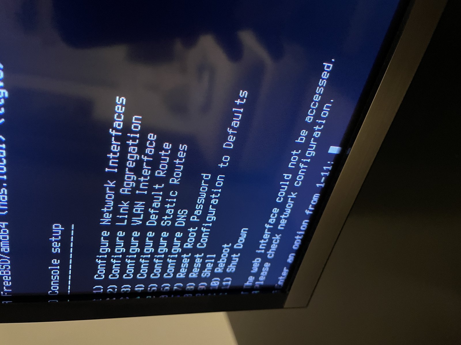

Hi all,
Would anyone be able to assist me with the following issue that seems to occur consistently when restarting the server. On boot I receive the following message:
The web interface could not be accessed.
Please check network configuration.
To enable the boot to continue I have to continue to Configure Network Interfaces and then reset them. Once I have done this, the system continues to boot and I am able to access the web gui.

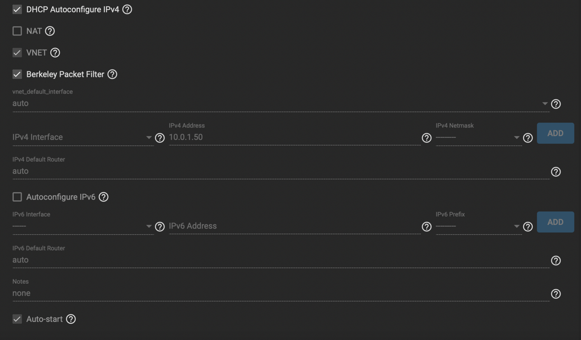

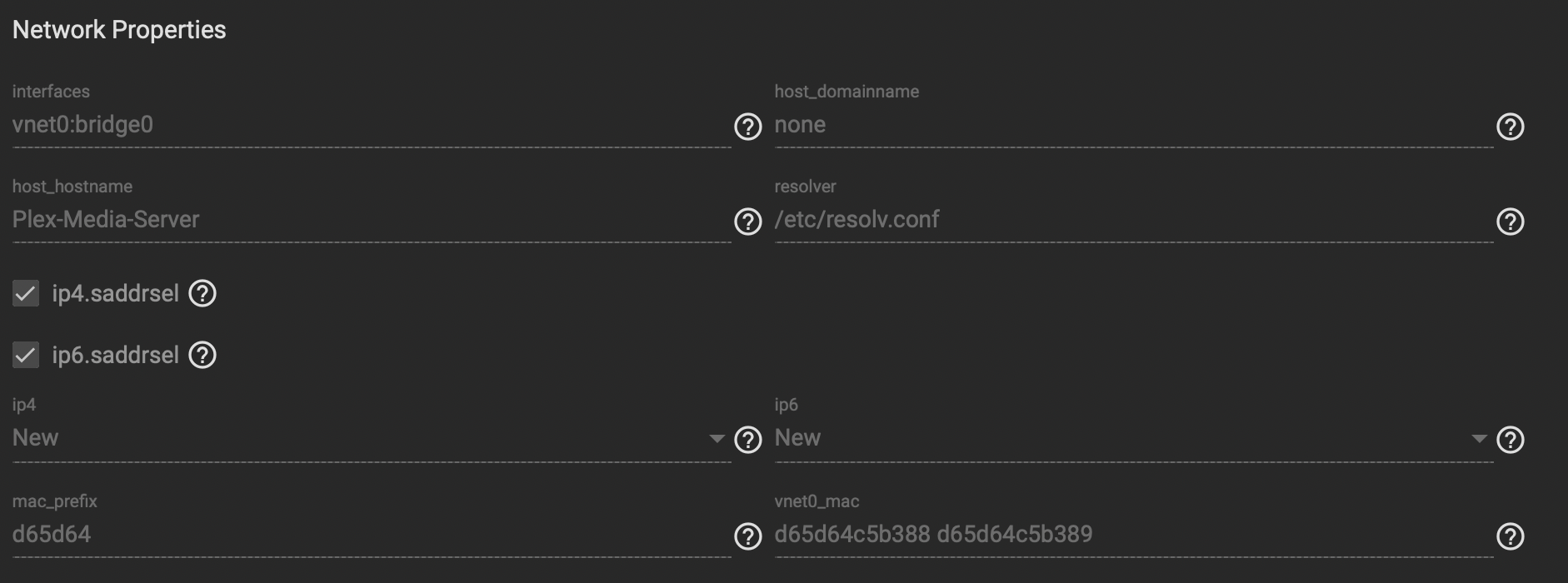

I have to plug in a monitor and keyboard to the server in order to view the error message and reset the network configuration. Otherwise the NAS is not accessible at all.
I have attached an image of the message that happens every time I need to restart the server. I have also attached some screenshots of the network settings in my Plex plugin.
I have tried restarting Plex etc but that doesn't seem to make any difference when server restarts - it consistently encounters the error preventing the boot.

In the jails basic properties, you do not have an IPV4 interface specified. In this field you should have "vnet0" without the quotes of course. Also on this page, you should have "24" in the netmask field.
The screen shot of the jails network properties look exactly like mine apart from the MAC address numbers.

@Ragetti I think vnet is actually one of the issue.
I would still like to verify your system can reboot and see if you can access the web interface. You can edit the jail so that it doesn't use "Autostart". From there, rebooting will or should give you an indication whether this work or not.
If it does work, then you can start exploring vnet.
On my end, I don't have "Berkeley Packet Filter" enabled.
