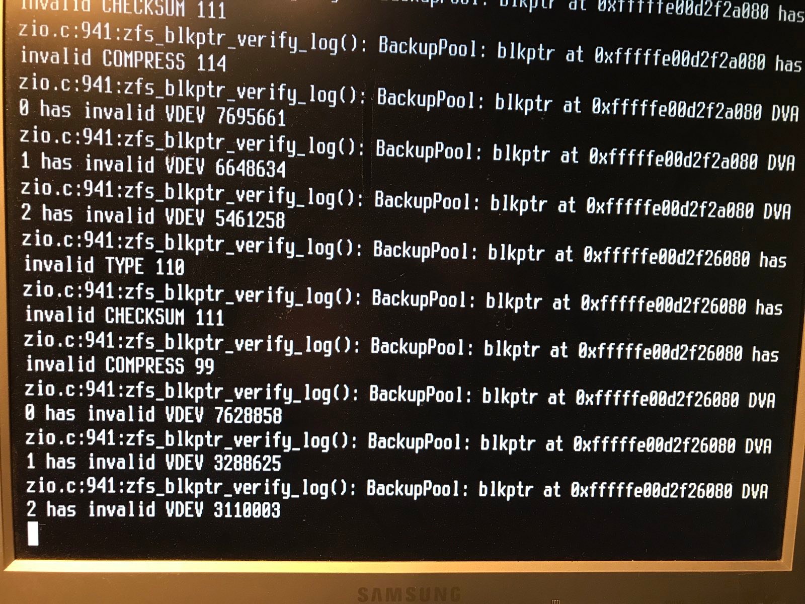

The main issue started when i tried to boot form a previous image in the boot drive. When i used the 12.0U8 option
After that, i got this error every time it boots, during the "Importing pool" phase. It dies there, i dont get the option to write commands either.

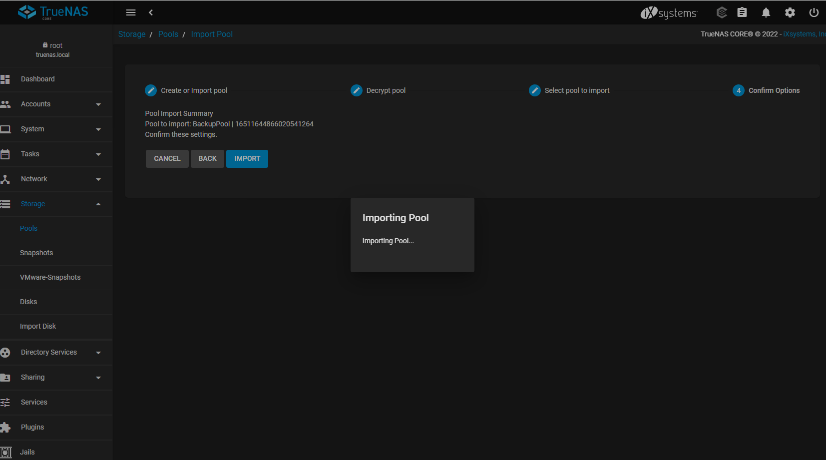

I tried with a truenas core fresh install, and tried to import the pool.
The pool was listed OK, but after 48hs importing pool didnt finish

after a reboot, the system hangs during boot like the previous install with the INVALID VDEV error

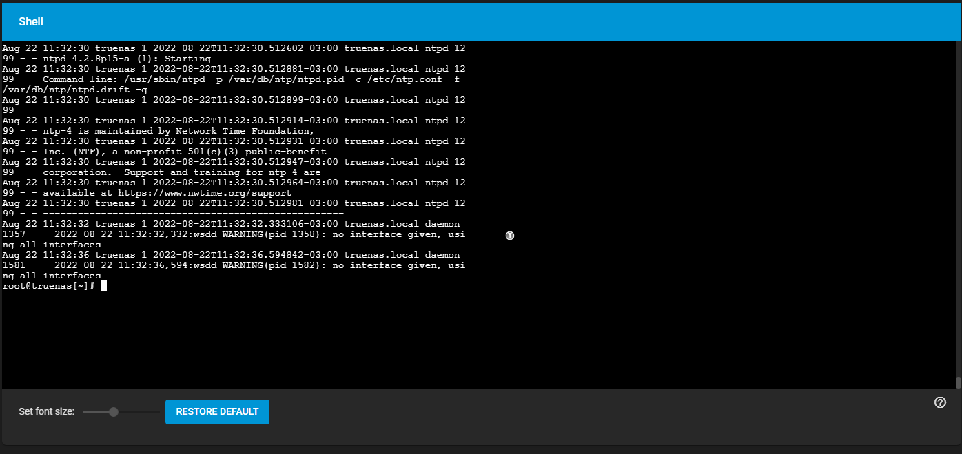

I tried to import the pool in a new pc, with new cables but i get stuck with the same "Importing Pool"
This are the last lines in Shell more /var/log/messages. , just looks like the last part of the boot process
No Pool Import error
