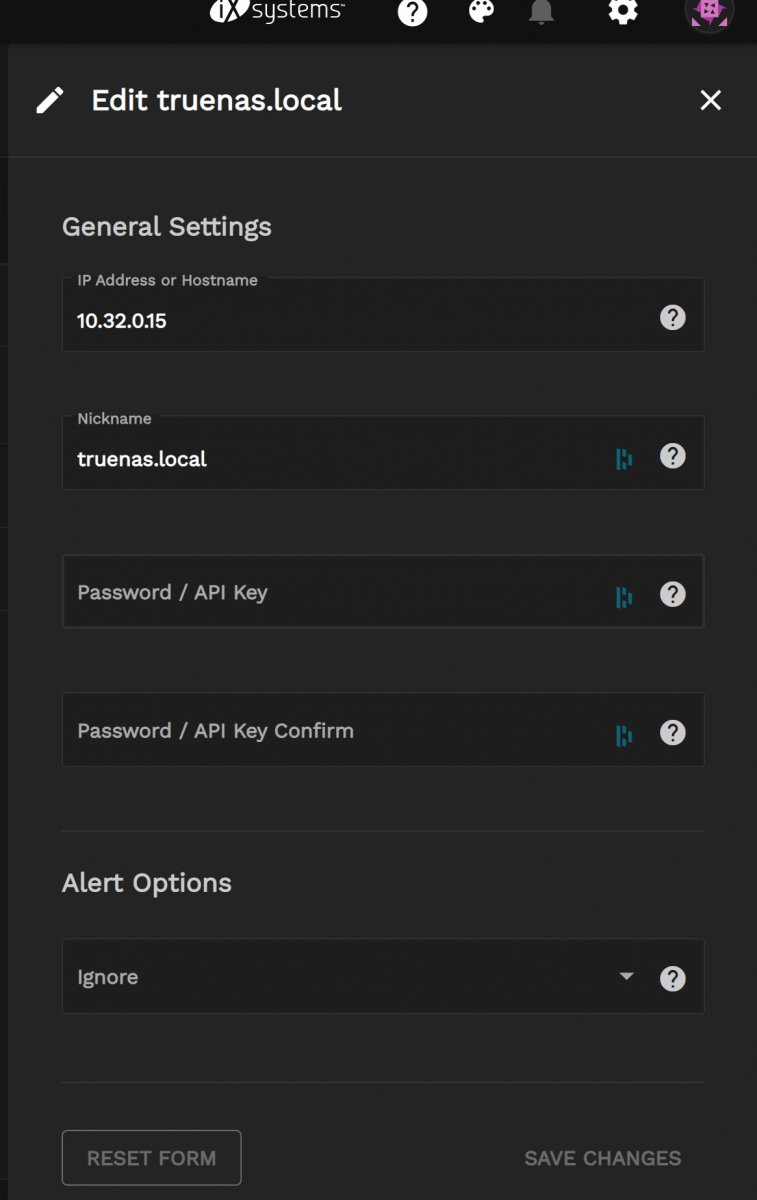

  • General settings for one of the systems (System card Options > Edit)

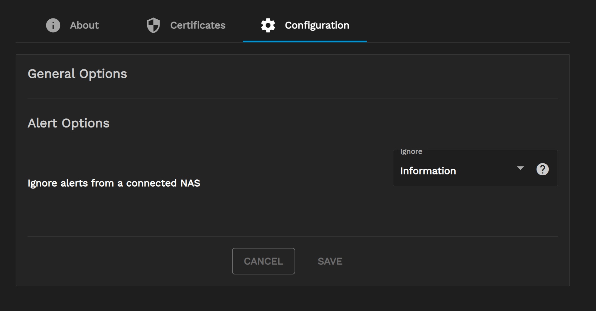

  • SSL Options (Dashboard Settings > Administration > Configuration)

screenshots in attachment

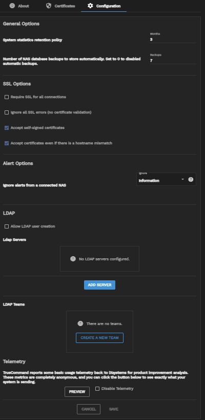

That second screen is unexpected. Try clearing your browser cache and see if this changes. Which browser are you using? I expected to see something like this:

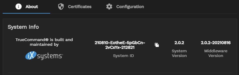

If you're using the TC 2.0.2 release, you should see the Middleware Version shown below under the About tab:

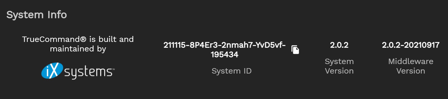

system info just here
I 'm just clearing the cache of my firefox browser, and it's always the same informations ...

@aervin I can't explain the difference in Middleware Version for the 2.0.2 release. I have it as 2.0.2-20210816. The OP has it as 2.0.2-20210917. The OP's configuration screen is also missing a lot of options. Any ideas?

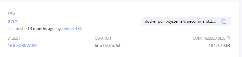

@BOSSEB69640 What image tag version did you use when setting up TC? I used tag release (which should be the same as tag 2.0.2). According to Docker Hub, 2.0.2 was released 3 months ago, which would place it around mid-August rather than mid-September.
