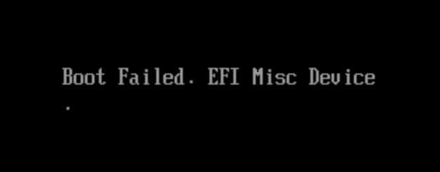

Unfortunately this is all I get:

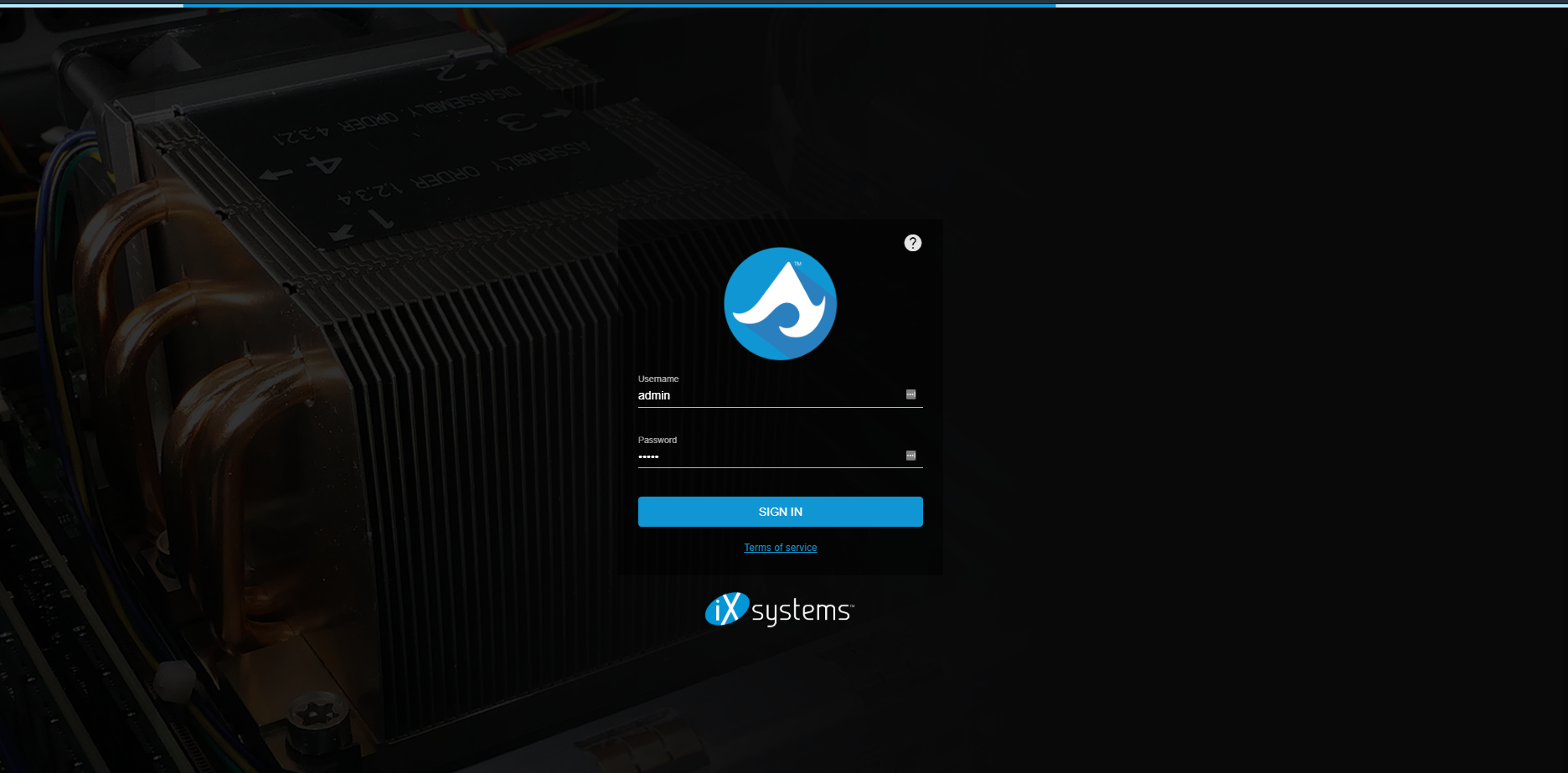

Mar 16, 2020
5
Hello, Im having a problem with the first login admin:admin
basically it just do nothing but adding some kind of loading bar on top of the page
note I tried
chrome without extension
opera browser
edge
explorer
mobile device browser and does the same thing
Heracles
Feb 2, 2018
1,401
Hey Pant,
Some fixed that case by updating their Docker daemon. So what version of Docker are you running as of now ?
