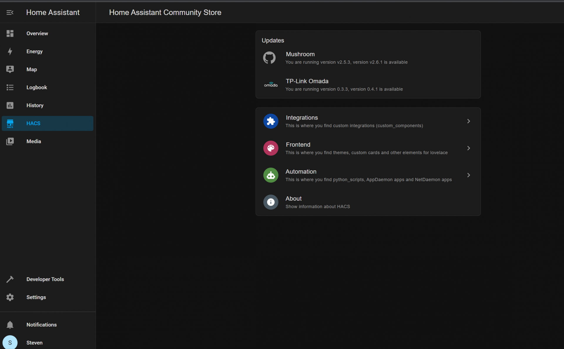

You can install the Community Store and addons inside TrueCharts Homme Assistant for example, but external packages like NPM nope
andyjay777
Jan 31, 2022
27

Can you explain how you installed the HACS please?
It’s a VM. You need to install it as such. Addons are only available that way.
If you go to the home assistant website, you can download the VM image.
HACS is fully available in our chart.
Sorry. I was thinking of addons still…
