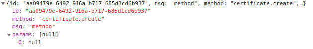

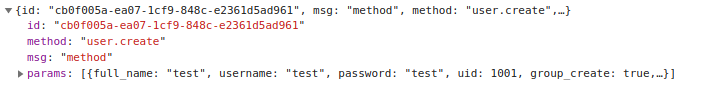

I've had this issue also on my test setup. I've been investigating what the exact issue is. First I thought it was located in the middleware which validates the input before executing the import.
But I saw that the frontend is sending null data through the websocket to the middleware, and then the middleware obviously flips off the frontend.
In the first image, you will see that the frontend is sending null data to the middleware when executing the method certificate.create
In the second image, I captured the parameters of the creation of a user, which are correctly being pushed to the middleware.
ornias
Neophyte Sage
Mar 6, 2020
1,033
There where a multitude if these similair issues with the certificate UI, all of them are kinda the same grade of issue (null or wrong var type send to middleware or from middleware to UI) 3 that I know of:
- Cloudflare not showing
- CSR not processing SAN correctly
- Can't add or import certificate (yours)
2 out of these 3 where fixed the last week-and-a-half... It just takes some time ;-)
When you have a whole bag of these "minimal effort bugs", it still takes a lot of time to go over all of them ;-)
