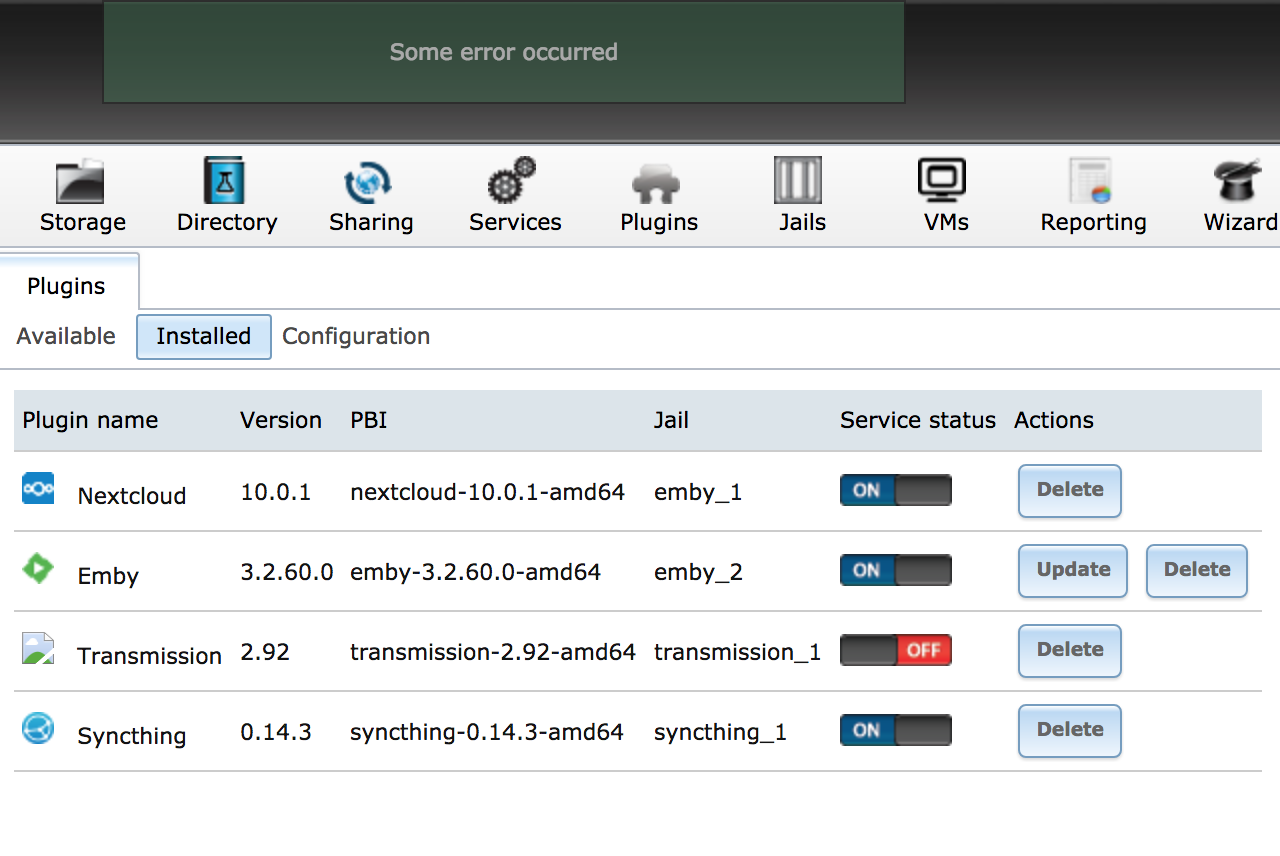

The red toggle of Transmission Plugin wont turn on. It says : "some errors occurred", see screenshot.
What's the problem? Where can I find the log of this errors?
Thanks a lot

In /var/log/messages.
Thanks a lot
Here are the errors. What does it mean?
Mar  6 23:44:20 freenas uwsgi: [freeadmin.navtree:614] An error occurred while u
nserializing from http://192.168.1.152/plugins/transmission/3/_s/treemenu: Expec
ting value: line 1 column 1 (char 0)
Mar  6 23:45:15 freenas uwsgi: [plugins.utils:88] Couldn't retrieve http://192.1
68.1.152/plugins/transmission/3/_s/status: Expecting value: line 1 column 1 (cha
r 0)

What's your FreeNAS build version (from System -> Information)? Have you ever switched to a nightly train? Those column errors tend to occur when you restore a config made on a nightly on a stable version.
