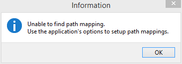

I have created a dataset on my main volume labeled Transmission with 2 folders, one for Downloads and one for Torrent files. I set the share type as windows and the permissions as windows: nobody/nogroup since I'm the only person on this network and my main volume is already setup as a CIFS share. I set the jail storage source as the Transmission dataset and the destination as /media. I set the watch directory as Torrents and the download directory as Downloads from the Transmisson plugin menu, then turned the plugin on. When I download a torrent file nothing happens. So, tried adding a it manually by browsing to the file and that works. The torrent starts to download and everything goes fine, no stops or error, but the file doesn't show up in the Transmission/Downloads folder on the main volume. When I right click on the torrent from the Transmission Remote GUI and click "Open containing folder" I get a message saying "Unable to find path mapping. Use the application's options to setup path mappings."

Update: So, I've updated the permissions and added my windows user to connect to my CIFS shares instead of using nobody/nogroup. I've also added a transmission user with UID:GID of 921 and assigning it to my Transmission dataset but I'm still having the same problem.
