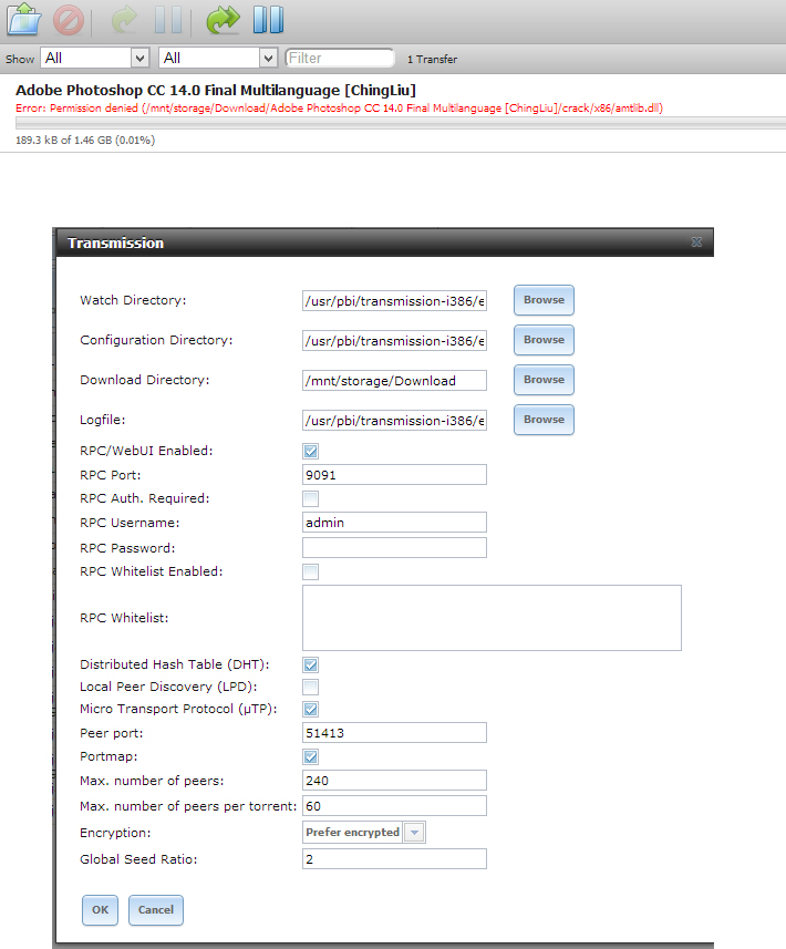

What could be wrong? I'm new to FreeNAS, and i've manged to get all configurations done. Just I cant get this Transmission to work linking it to my Download folder!
"Error: Permission denied"
I can tell its something got to do with permissions on my Download folder. I would appreciate your help. Thanks

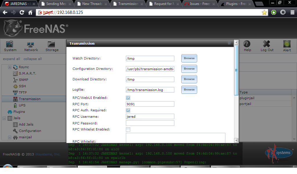

Depends how permissions are setup.. I do my own permissions by hand before moving stuff currently.. It's been awhile since I worked with transmission.. My guess is transmission doesn't have permission to write to the folder.. Just create your own folder with full perms link it to the jail /tmp (or any other directory where your not having problems).. Let transmission write there.. http://doc.freenas.org/index.php/Plugins
Edit: I've never touched the transmission config as far as I know..
Well, your download directory is pointed to a folder inside the jails .. i would like to point to a different directory called /mnt/storage/Dowload
Whats the possibility assigning a directory for downloads not from within the Jails?

You can link to a directory outside of the jail: http://doc.freenas.org/index.php/Adding_Jails#Adding_Storage. The transmission user will need permissions to the outside dir as well.
Thanks dlavigne! Damn, how come I missed that menu on the left side.
For those who still wonders:
Go to the left drop down menu called "Jails" (Find you pr- created jails name) and pick it up "dlna_1" in my case and "Add Storage" and simple assign directory and mirror it.
