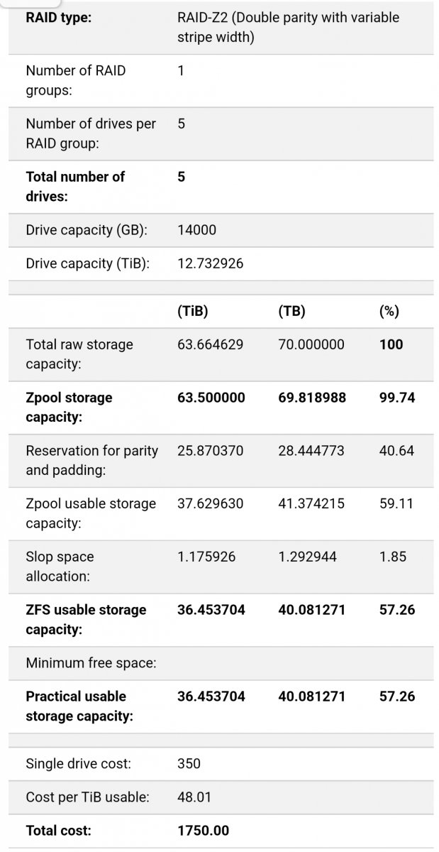

I do see what you are saying. Mirroring and raidz1 are both expensive based on the capacity loss. It will be a while before I am comfortable with the software along with having the funds to build it. Would likely be best to go with a 5 drive raidz2 that will only be a 40% loss and effectively triple my storage, in theory. An extra $350 to buy one additional drive is only about 1/8th the cost of the entire build. See attached.

I'll have to look in to building a degraded raidz2 and adding the drives later. That is one solution. I will also have to look at a backup. Might have a solution to do that. Copy everything off, build my array and copy it all back to the new device.
