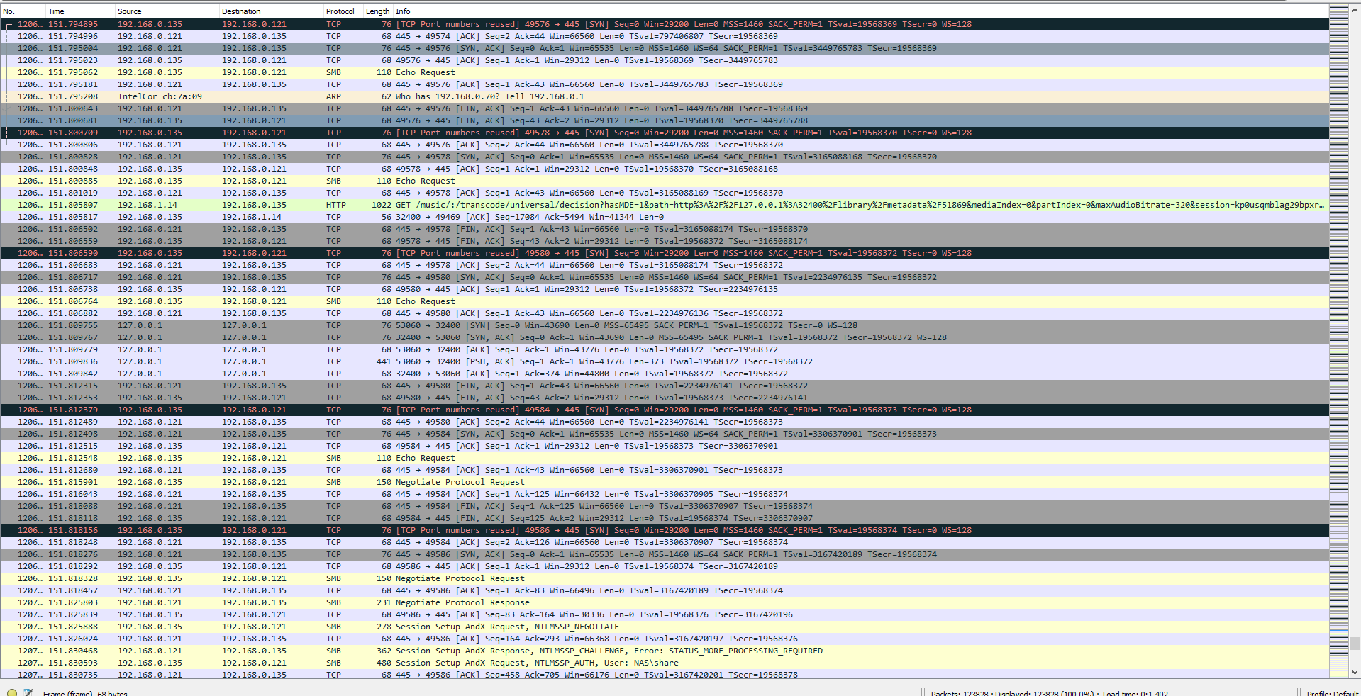

Hello,
I have an odd problem that has only begun to occur recently. I have a Plex install in a Ubuntu VM with a cifs mount that points to a SMB share on my FreeNAS host. It was working well for many months. Now all of a sudden, I am finding that if I have not read or written a file to the share from the VM in the past few minutes, the share becomes inaccessible for 2+ minutes. Watching a packet capture, during this period, FreeNAS appears to quit responding to SMB requests and the Ubuntu host starts spewing thousands of SMBEcho requests that go unanswered.
FreeNAS-9.10.2-U3 (e1497f269) but it also occurred on FreeNAS Corral for the past week, It was what prompted me to try rebuilding on 9.10.
Watching logs on FreeNAS, it appears that the SMB process either exits or crashes during this period of time.
I have a packet capture of the behavior.
And attached are the logs from my FreeNAS host.
  • freenaslog.txt

I am uploading another debug that shows two hosts having the problem in the network dump, 192.168.0.135 and 192.168.0.80 are two different Ubuntu 16.04 hosts showing the same symptoms, If I try to manually mount the share during this "outage period" I get message "mount error(122): host is down" Please note that I do not seem to be seeing the same issue when browsing from a Windows host.
  • debug-nas-20170506235944.tgz

For sure, when the mount is down there is an enormous spike in SMB Echo requests on the Network interface which is causing 20-30% CPU usage on the NAS. Once it finally mounts, CPU usage drops again. I appreciate that knowing NFSv4 does not pose the same issue, however that won't work for me as I have many Windows Home Clients that will be accessing the share as well.
What grinds my gears is that I was running this for quite awhile before this starting occurring on Corral and then 9.10. The only thing that changed in the meantime may have been an increase in storage usage on the volume.

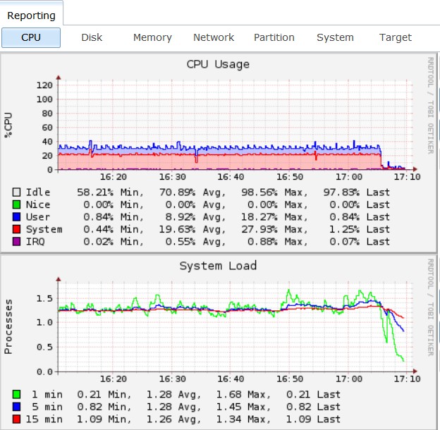

I'm experiencing the same high CPU utilization and dropped connections with a Ubuntu 16.04 LTS VM using a CIFS-based share on my main FreeNAS 9.10.2-U3 server. I've reverted to the earlier Ubuntu kernel per @shwetkprabhat's instructions and everything seems to be running the way it ought to now. The SMBD process was running the CPU utilization up to ~28% before I made the change:

I am running FreeNAS 11 and the problem was not resolved. It seems that the problem is actually the Ubuntu machine trying to access the shares rather than FreeNAS itself. I've since switched to NFS shares only and it is running like clockwork.
anodos

I'm experiencing issues like this as well for the past day or so after updating Ubuntu. I got alerts that my FreeNAS was running nearly 100% CPU all the time.
Looking at the processes it was almost all smbd. When I turned the SMB service off on FreeNAS, my CPU dropped immediately to near 0 (around 21:20 in graph below). I then shutdown my two Ubuntu boxes and re-enabled FreeNAS SMB service. CPU stayed around 0.
Finally, I turned on one of my UbuntuVMs and you can see the FreeNAS CPU shot back up to about 50-60%.
For the moment, I've killed the SMB mounts I had configured while I decide if I want to mess around with the Kernel or just move to nfs.
After unmounting the FreeNAS smb shares on my Ubuntu boxes my FreeNAS CPU is back where I expect it... (I am still using them from Windows and Mac without issue):
Will be watching this thread closely.
