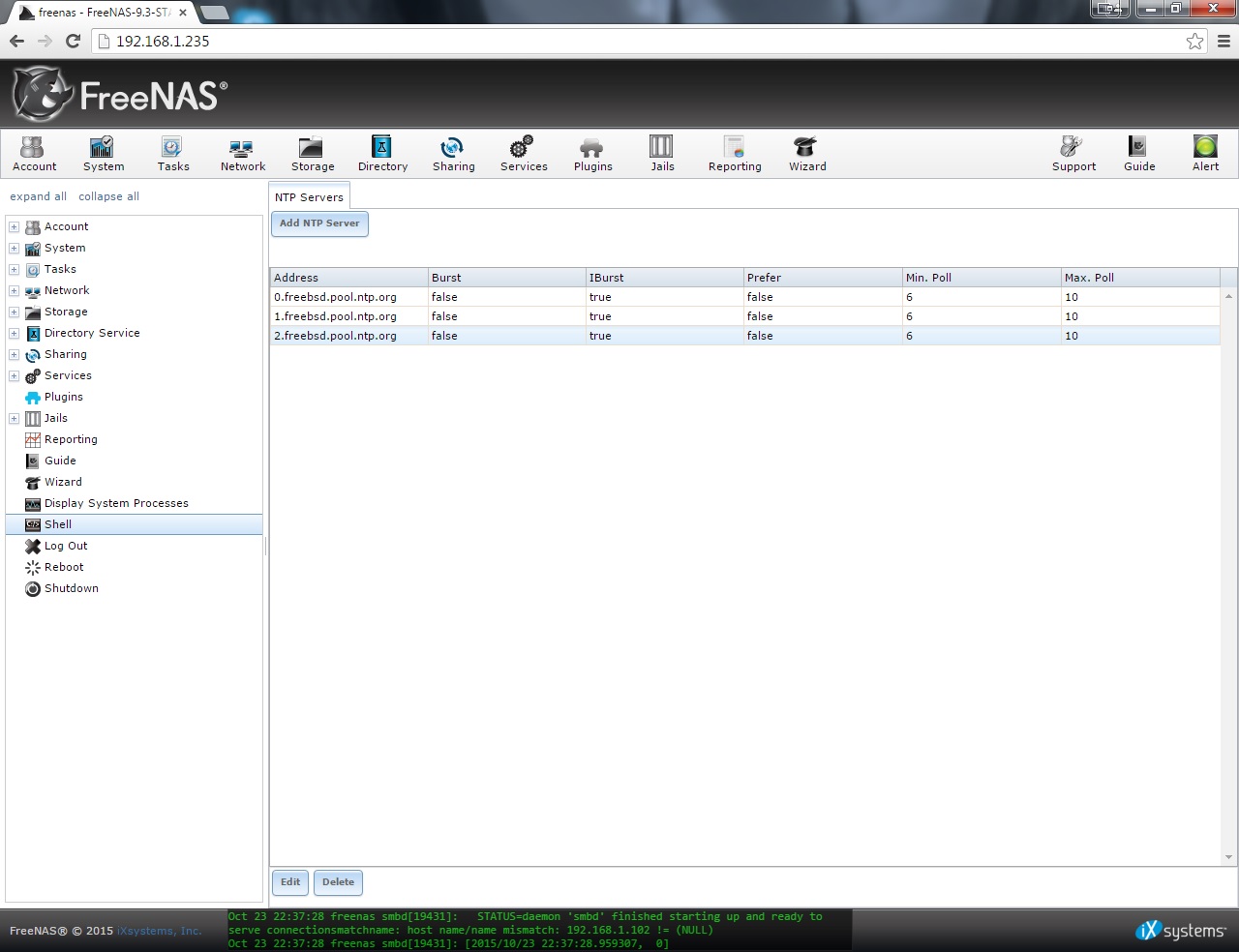

Go into System->General->NTP servers, and screen shot that for me (or, tell me what servers are configured)

Here's the screen shot. As for the ping 8.8.8.8, I guess it's working because it's still running. When it finishes, I'll try the second one.
Ok, dig www.google.com works also.
