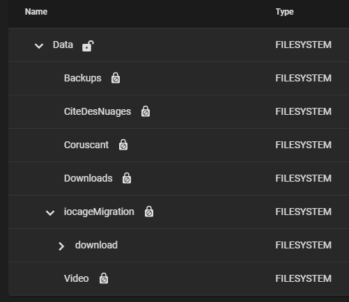

This root dataset is not encrypted itself, but has encrypted children.
tommyatkadx
Mar 3, 2018
5
I am in the process of migrating from TrueNas Core to TrueNas Scale.
I use the replication task to replicate encrypted datasets (Legacy Encryption) from Core to new encrypted dataset on the new Scale server.
Everything seems to be working, but I have that weird icon that says "This root dataset is not encrypted itself, but has encrypted children." and I don't understand what I did wrong.
How do I fix that?
Thank you very much
Vitacola
Nov 18, 2017
5
Hi, same issue here. How to decrypt the replicated datasets?
Vitacola
Nov 18, 2017
5
Got a solution.
"Include dataset properties" nee to be unchecked, on the sending side in the replication task setup.
Than, the received Dataset on the remote side are not encrypted.
