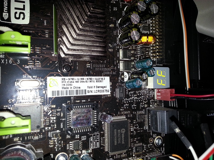

The motherboard is: XFX nForce 790I Ultra SLI
http://www.nvidia.com/object/product_nforce_790i_ultra_sli_us.html

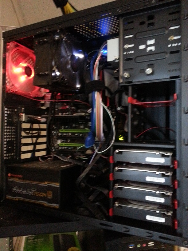

I think there are two different controllers for the 6 satas on the mother board: three connectors are grouped together (the three in question) the other two are connected to the sata connectors in a different spot on the board...
I do not want to shut the nas down, afraid to loose 5TB of data..... Where to go from here? Can I hot swap that bad drive to restore my pool prior to restarting or going to bios...? Can you please give me a link to this how to please......
thanks for all the support, its great to see there is a good community behind this software. thank you in advance!
Are the three drives FreeNAS can't see arranged in some sort of RAID by the controller? Check this in the BIOS.
I would estimate that the risk to your hardware and your data is much greater from attempting to hot-swap a disk than from shutting down the system through the web GUI. We don't know if any of your hardware supports hot-swap, and even with hardware that supports it completely it's a risk.
Exactly. Don't let emotion get the best of you. Use logic... and it is illogical to assume hotswap will work if you haven't tested it and can vouch for it working.
