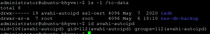

I should probably expand on the OP.
Where TC starts correctly, and uses local storage, this is what the permissions look like for the hostdirectory:
When hostdirectory is mapped to a FreeNAS share, and TC fails to start, the snippet of the startup appears as follows:

Ownership for the mapped hostdirectory looks weird.
If I set up a user avahi-autoipd (UID/GID=106) on the FreeNAS server and make it the owner of the dataset that the NFS share maps to, the snippet of the startup is as shown in the tail of the OP. Ownership of the mapped hostdirectory is still weird and looks similar to the previous screenshot.

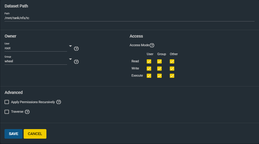

It looks like the FreeNAS has not granted write access to the host/docker. Basically, the NAS is blocking TC's access to the /data directory.
Hi @aervin, the guide I followed gives full access to world for the dataset.

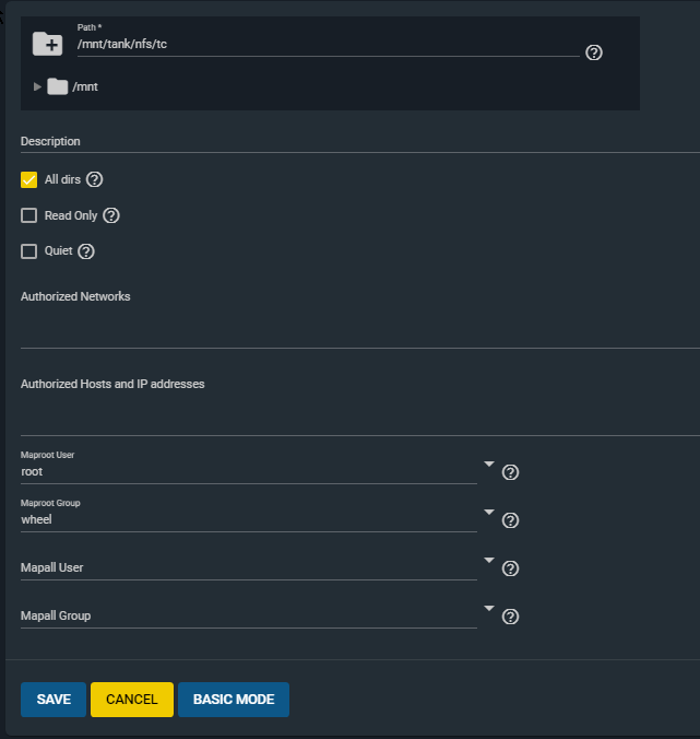

anmnz
Feb 17, 2018
286
This looks exactly like you have processes running as root in the Docker container, but you don't have "maproot" set on the NFS share, so the NFS server is mapping "root" to user "nobody", and as a result your "root" processes don't actually have the permissions they expect.
Jan 4, 2014
1,644
This is unfamiliar to me. I'm assuming I set the advanced share characteristics as shown?
EDIT: That resolved the issue. Thanks @anmnz!
