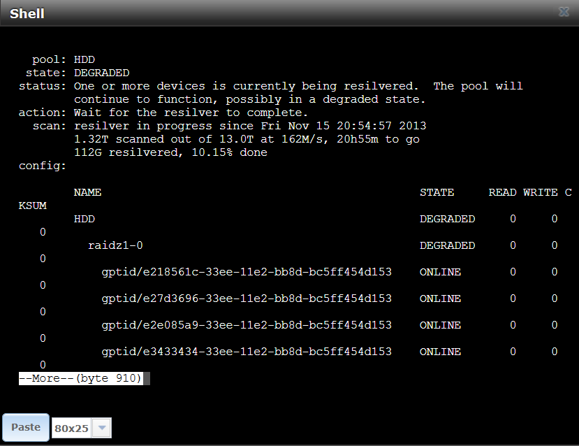

Hello
I replaced a drive and resilvering is ongoing but for some reason a second drive seems to be resilvering at the same time, which is weird because I have only one drive set up for redundancy.
I can't post CODE but I thought a screen shot instead will do:
So here is what I am seeing when I run zpool status:
If I run -v I get a lot of file errors but when I check on those files they seem to be ok.
At some point the machine will stop responding and I have to restart and the process starts again.
Is there a way out of this?

Any chance you can post the entire output of "zpool status"? A bunch scrolled off the screen on your screenshot. You can make it go one screen at a time with zpool status | more.
Gunhead
Nov 20, 2012
12
thanks for the tip at last now I can see the progress. here is the first screen
