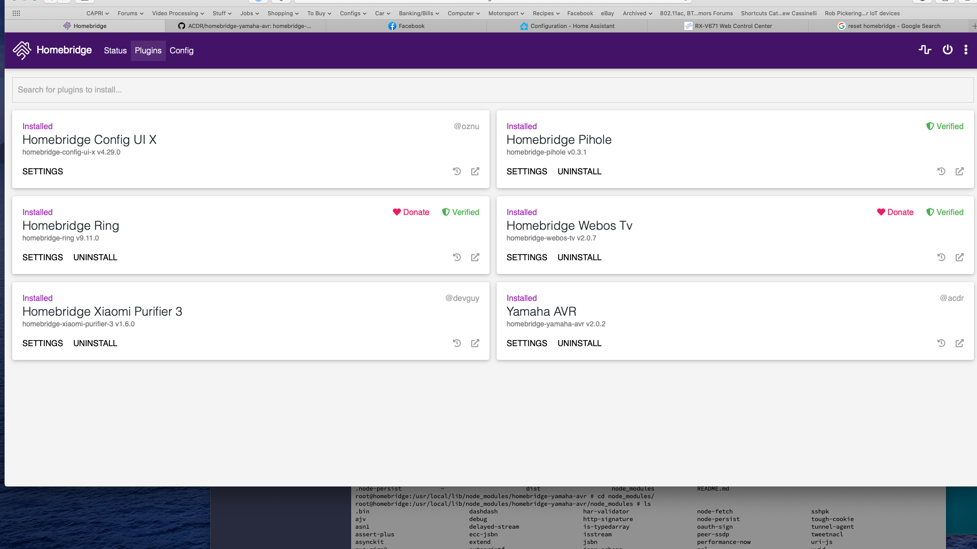

Recently upgraded to TrueNAS 12 RELEASE after running the beta's and system was running fine on RC1.
Since upgrading the system is becoming unresponsive after about 24hrs, checking the logs I can see that it is running out of swap space and killing the network connections it seems, system has 32GB of RAM, and looking at logs RAM utilisation is completely fine, so I'm at a bit of a loss
Error messages in console look similar to this for many different processes:
Nov 1 08:51:30 Fileserver kernel: pid 361 (python3.8), jid 0, uid 0, was killed: out of swap space
