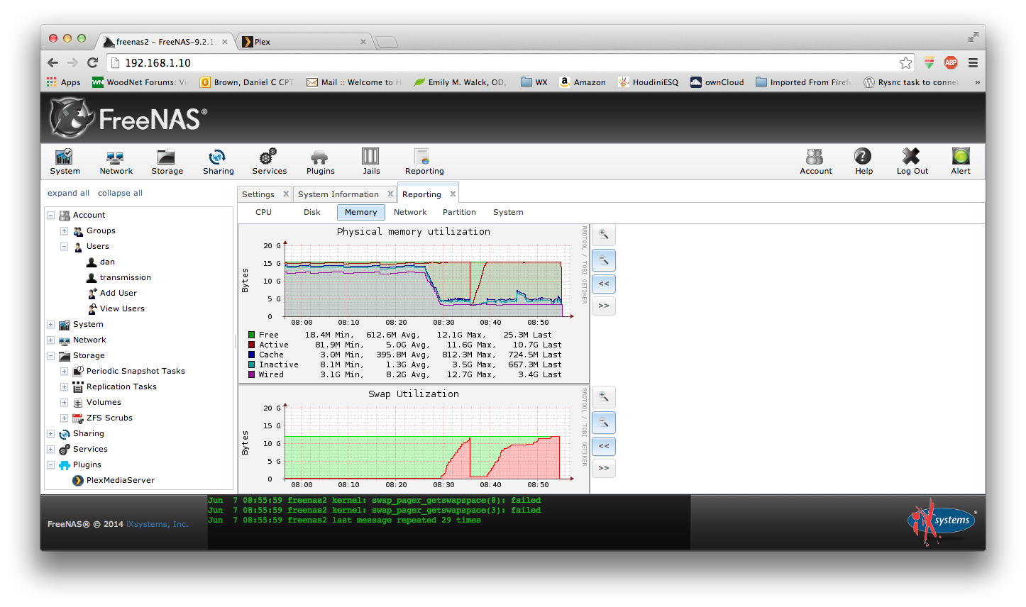

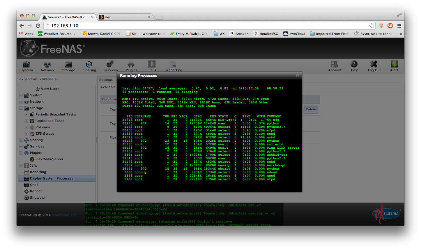

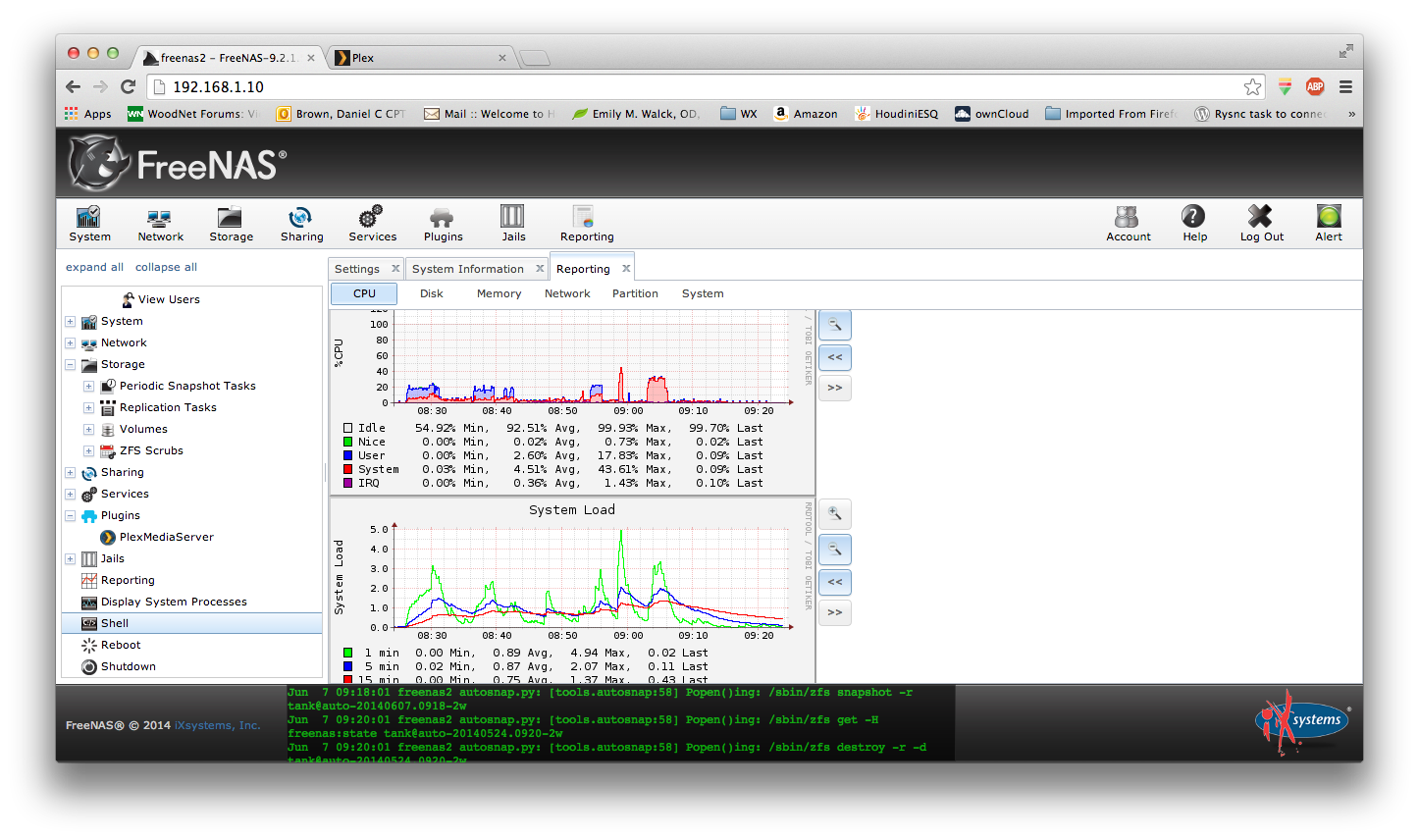

I've been noticing the same issue in my security email the last couple of days, and a few minutes ago I happened to be sitting at my computer with the FreeNAS WebGUI up and noticed the "swap_pager_getswapspace(16): failed" messages in the bottom pane.
System specs are an X9SCL-F-O motherboard, Xeon E3-1230V2, 16 GB RAM. Pool size is 10 TB. I'm running FreeNAS 9.2.1.5 with the Plex Media Server 0.9.9.7.429 as my only plugin. I've attached screen shots of the memory reporting page, the CPU reporting page (a bit delayed), and the top output. I noticed that top indicates python is using over 19 GB of memory, which sounded ridiculously high. When I turned off the Plex plugin, the memory usage decreased drastically.
At the time, nobody was watching or listening to any Plex media. The Plex server may have been reindexing the library on its own schedule (I hadn't manually started a rescan). I was ripping a DVD to a CIFS share on the FreeNAS server. As an interim measure, I've created an additional 16 GB swap file. I'll see what that does, but I don't think that's a reasonable long-term solution.
Edit: I've restarted the Plex plugin. Right now, python is in top as using about 12 GB of memory. User 972 is also the user idea listed for Plex Media Server and its other processes. So I think it's accurate to pin this memory usage on Plex.
