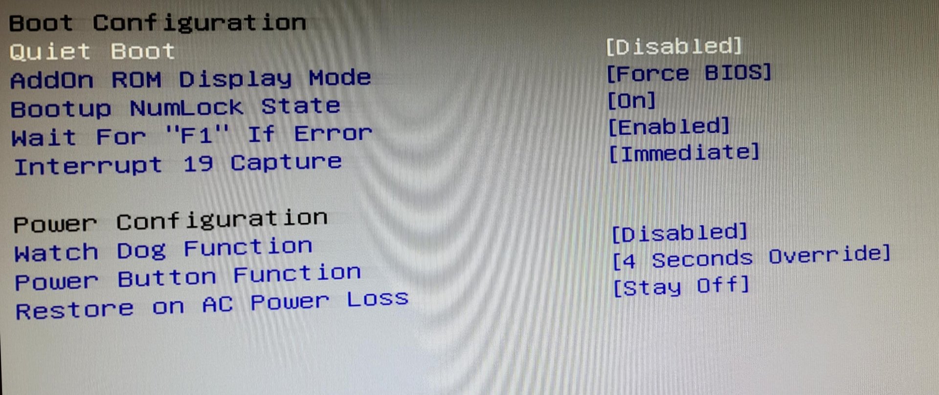

A wild hare, from the manual:
Watch Dog Function If enabled, the Watch Dog timer will allow the system to reboot when it is inactive for more than 5 minutes. The options are Enabled and Disabled.
I can't find it in the manual, but are there any setting for a sleep mode?

I hadn't thought of Watchdog, but it was turned off. I did change the restore on power loss though.
