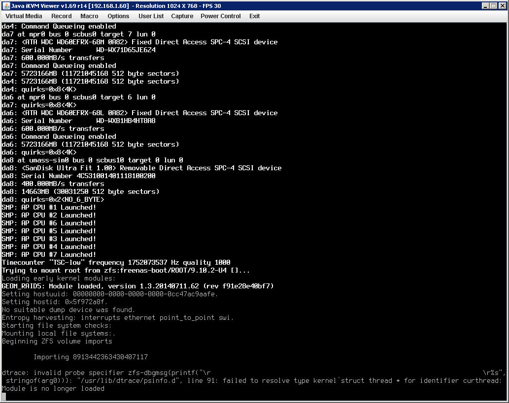

I just upgraded my LSI3008 onboard controller to P14 and the system failed to boot ( that was the first assumption which was wrong ) with a dtrace ( see screenshot attached )
I then downgraded again, same problem. So I investigated a bit more and the only other change was adding a L2ARC SSD ( Intel 240 GB ). So I unplugged the SSD and the system booted up fine, the error message still appears but the system continues to boot up. After that I re upgraded the LSI3008 firmware to the latest version ( as this clearly isn't the problem )

- The systems hangs for about 5 minutes at the position depicted in the screenshot when the L2ARC SSD is installed AND added to the pool as cache device.

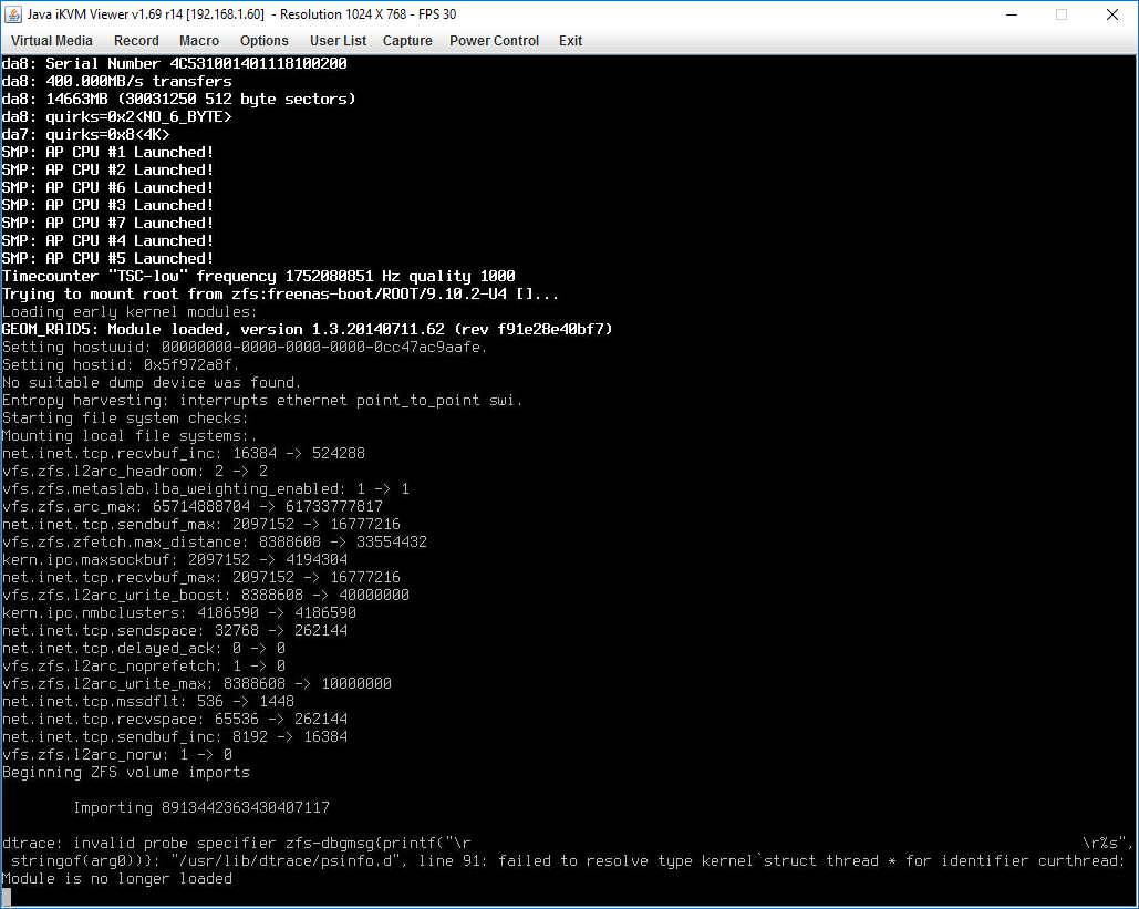

I also noticed in the screenshot, you have a ton of sysctl's being set. Did you enable autotune? If you did, just disable it, delete all the sysctl's it created and reboot. Autotune is only ever needed on very large systems.

Yes I have autotune enabled, but I will disabled it for further testing.

I suspect it has something to do with the dtrace error, I googled it a bit and it seems to have something to do with UEFI boot which is what I'm using. I will keep monitoring the issue and maybe I'll come up with a solution.

Disable autotune and remove the tunables that it sets.
Morpheus187
Mar 11, 2016
61
I removed autotune and disabled all tunables that it sets, the 5 Minute delay during boot still exists: See screenshot.

What is this dtrace thing? Did you turn it on? Turn it off if you did. Also try making a new boot usb and bit that just too see if it's the install breaking.
Morpheus187
Mar 11, 2016
61
