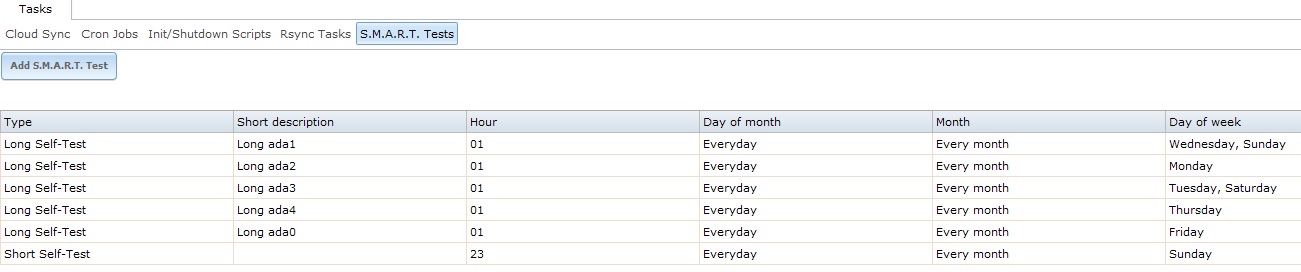

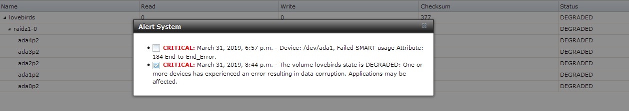

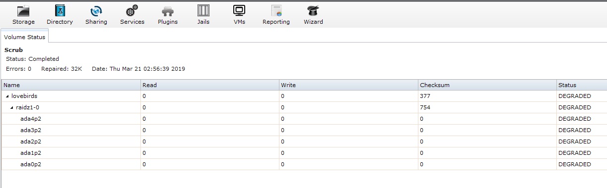

You can see in the attached JPGs that I have (5) 3TB drives now running in a degraded status.
Most recent long SMART tests show no issues.
Older SMART tests showed a one-time issue with ada1 but that drive now is passing long SMART tests.
Likewise, some months ago ada3 had a one-time failure but the status showed degraded for only a short period of time. After subsequent SMART tests volume status showed "online".
I included any screen shot I thought will help.

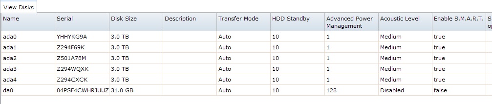

I have the adax and corresponding drive serial numbers but do not know how to drill down on the degraded status to know what action to take.
Thanks.
