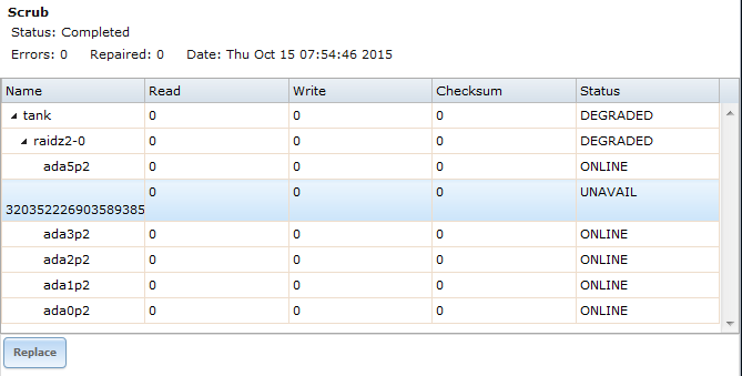

Over last weekend (I know, I know, I should have posted a thread earlier) I received an email that my pool had gone into a degraded state.
When I got home from my business trip and could investigate, a drive had completely fallen off of the system, and volume status showed as 'UNAVAIL' and gave no option of marking as 'offline' per the manual:
http://doc.freenas.org/9.3/freenas_storage.html#replacing-a-failed-drive
I have since received an advance RMA from WD for my 2TB Red (2nd failure of 2TB RED in less than one year out of 6 drives, not terribly pleased...) and the new drive has passed the smart short, conveyance, long, badblocks, smart long test with no errors and I am looking to get this drive resilvered as soon as I can so I'll sleep better at night.
Upon investigation, which I admit I may have jumped the gun by powering off the server and removing the drive-- the drive's motor completely fails to spin up and BIOS will not see the drive as plugged in. complete total failure of the drive. I suspect possibly the controller board has failed, but do not want to risk trying to replace the old drive's board with the new WD refurb board.
My question is how to procede since I cannot mark the failed drive as offline.
I do have the 'replace' button when the drive is selected in 'volume status', and I would assume that I would be able to pickup at 8.1.10.1 with clicking the 'replace' button, but would like to verify this is the proper method and not risk any other gotchas, uh-ohs, or otherwise unpleasant and unexpected happenings.
I did click on replace, and the new drive shows up as I would expect -- but I did not click continue and instead decided to cancel the repair process unless there is something I am missing.
Any help greatly appreciated, thanks!

This is what I have seen in the 'volume status' area, for clarity.

As you don't have the drive anymore you can't offline it (I've more or less the same problem, if I plug the failed drive in the server it won't boot...) just hit replace and follow the documentation from here ;)

Thanks Bidule0hm that's what I thought but I wanted to make sure.

The resliver is complete, and my status shows as healthy, thanks for the confirmation and looking over my info.
