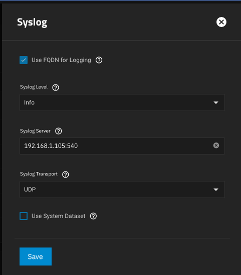

Hi all,
I've the TrueNas in proxmox and I want to centralize the logs using graylog, so at this moment I'm testing the graylog on docker-compose file on my machine just for test purposes.
I've configured graylog with the input for syslog UDP on port 540,
if I use the command line on truenas "logger -s -n 192.168.1.105 -P 540 -d testedrive", I receive the log on graylog without any issue.
But I I try to do only logger mylog in console, I'm unable to get the log on graylog.
This is my configuration in TrueNas Scale.
Why this is not working?

tcpdump is the usual tool used to inspect network traffic. Syslog is on port 514. So try something like
# tcpdump host 192.168.1.105 and port 514
and then generate some syslog traffic.

Also, I noticed in your config you are using port 540. Is your syslog server listening on that port?
Can you run this command on your syslog server? What does it say?
netstat -tunlp
My syslog server of choice is Gravwell, but the output of this should look the same.
