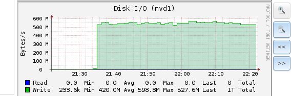

Feb 19, 2015
508
It boils down to having a good slog device.
This is a Intel 750 PCIe 400GB drive. Works great for us!
