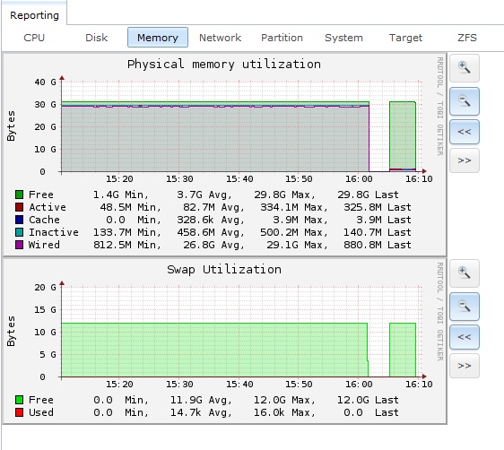

I'm seeing swap space being used after a few days of uptime since upgrade to 9.10. Is this normal? It's happening with 2 systems. Details below.
System 1:
Xeon 1231, X10SL7 with 32 GB.
pool 1: RAIDZ2 with 6x 3TB WD red
pool 2: striped mirrors 4x128GB SSD
FreeNAS-9.10-STABLE-201604111739 (896cc83)
uptime: 1 day, 20:43, 0 users
Cifs shares and zfs replication to system 2
Just 2-3 users at the moment
System 2:
A1SAi-2750F with 32 GB
pool 1: RAIDZ2 6x 1TB WD Green
Only for replication from system 1
uptime: 2 days before reboot

It's only using a few KB on the swap, so it doesn't look like anything to be concerned about. Do you have any jails or bhyve VMs?
Also, post details from the ZFS tab for ARC.

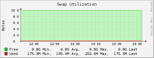

I have this on my 8GB backup system. It quite consistently ends up with an average of 200MB of swap used. Generally its some unused processes which get ejected.
Its not a problem, except when a disk fails, the box crashes with a pagerd fault. Which is a problem.
Is there a tuneable or something so that I can limit the ARC or something, so that it *doesn't* use the swap, although there is swap available?
And I guess... perhaps if it needs the swap, it seems like it never stops using it... perahps a periodic script to swap-off a given disk would do the trick?

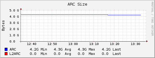

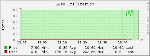

# swapoff /dev/ada0p1.eli ; swapon /dev/ada0p1.eli
# swapoff /dev/ada1p1.eli ; swapon /dev/ada1p1.eli
# swapoff /dev/ada2p1.eli ; swapon /dev/ada2p1.eli
# swapoff /dev/ada3p1.eli ; swapon /dev/ada3p1.eli
# swapoff /dev/ada4p1.eli ; swapon /dev/ada4p1.eli
Does result in swap usage going back to zero, in I think a safe manner (ie at all times there is still 8GB of swap available if it is *actually* needed), so I guess there's no reason I couldn't do that on a cron, but is it normally for this to generally end up with a few hundred megs of swap used after a day or so?

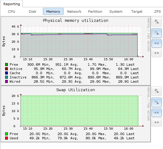

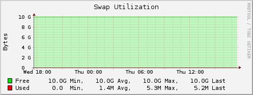

Stux
Jun 2, 2016
4,419

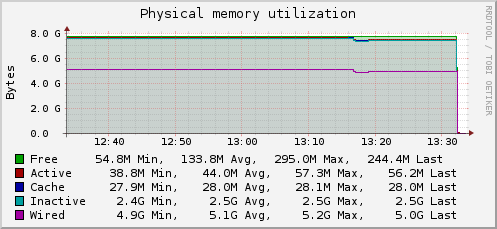

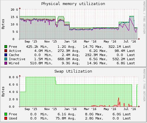

So, swap usage has gone back to 5.3MB. sometime over the last 24 hours.
You can see over the same period there was plenty of RAM available... after all the purple line is pretty much the ARC... which *can* be dumped.... right? And indeed should be dumped in order to prevent swapping... right?
Free gets down to 59MB. Should that not be more like 1GB?
You can see the ARC pretty much mirrors the Wired line... less 1GB.

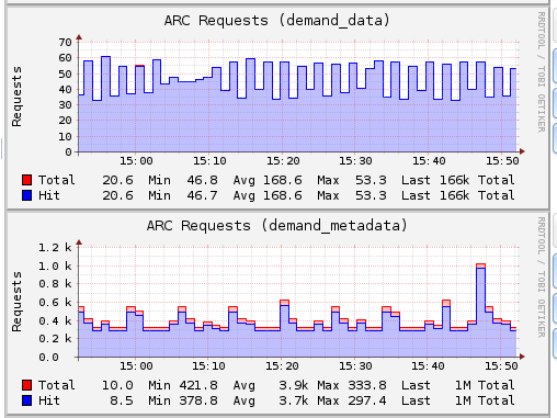

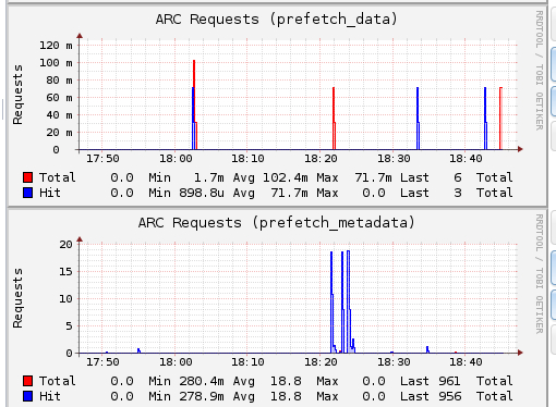

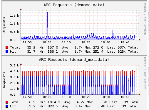

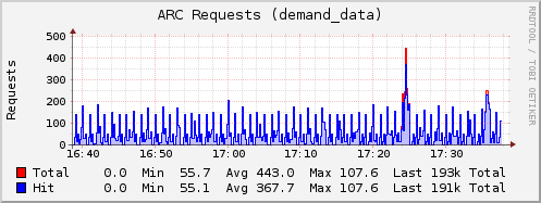

Is it possible that the issue occurred during this usage spike:
(when another server was restarted and remounted an iscsi zvol)

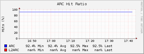

And Arc hit ratio for completeness.

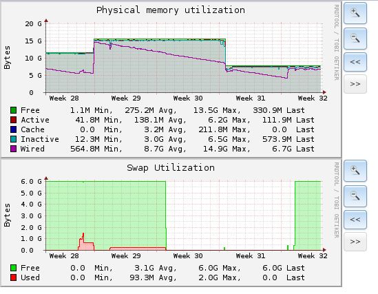

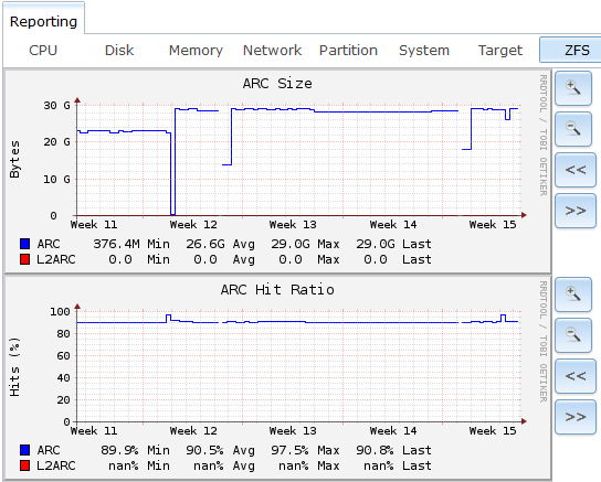

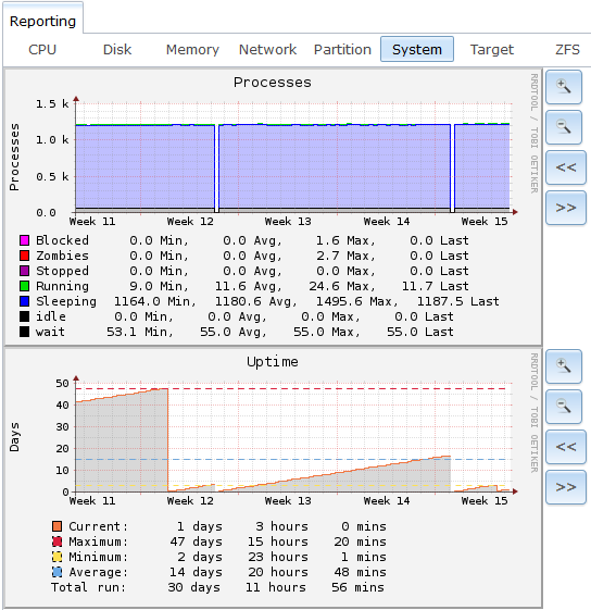

Since upgrading to 9.10 I'm seeing swap usage on my system as well, usually a few hundreds MBytes after a few days of uptime, so this seems to be normal in 9.10. In 9.3.1 swap was hardly ever used.
Pool1: Single mirror vdev 2x3TB
Pool2: Single mirror vdev 2x2TB
The upgrade from 9.3.1 to 9.10 was performed "at the W of Week 12" (time axis of attached screenshots). The increased arc size seems to be a direct consequence of a more aggressive default setting in 9.10. According to arc_summary.py vfs.zfs.arc_max has a value of 32296763392 on my system in in 9.10 and was significantly lower in 9.3.1. No autotune in action, no tunables set.
I don't know if swap usage in 9.10 is a consequence of the increased maximum arc size or some other changes that came with the upgrade.
