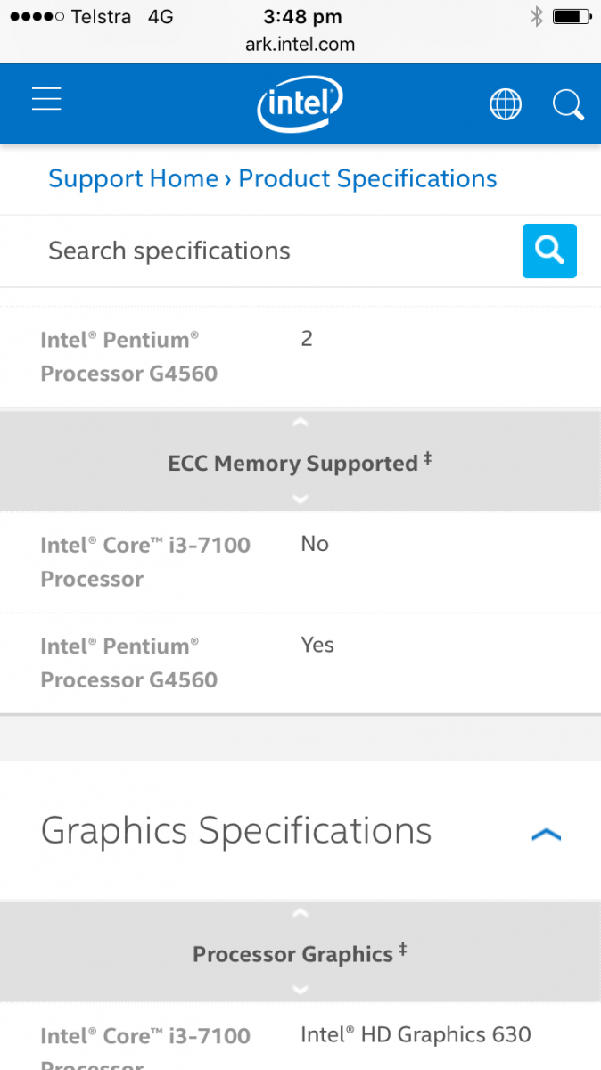

https://ark.intel.com/compare/97455,97143
Difference seems marginal. Just TSX, far as I can tell? And "Optane", whatever that is.

Also, that link says no ECC for i3 ;)
Seems like the Kaby advise should be go low or go Xeon.

I thought this was the case all along. The i3's have never shown ECC support on ARK and the Pentiums have. I've been recommending the G4650 as the budget CPU go to for a bit now. Hard to beat the offering and performance for the price.
Thank you @Stux. I have edited the original accordingly. It's all very confusing suddenly. :)
