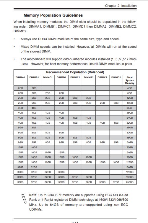

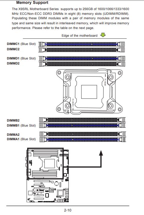

The manual tells me to populate the blue DIMM first.
I have four RAMS Samsung 16gb (each) 2RX4 PC3L-12800R (M393B2G70QH0-YK0).
Installing the RAM as per manual; DIMMA1 + DIMMB1 + DIMMD1 + DIMMC1, gives me an error on boot B7 and B9.

Do you have BIOS options to step down from 1600 to 1333? Try clocking the memory below the max. Reaching, admittedly.
This note in the manual: “ Note: Up to 256GB of memory are supported using ECC QR (Quad Rank or 4-Rank) registered DIMM technology at 1600/1333/1066/800 MHz. Up to 64GB of memory are supported using non-ECC UDIMMs.”
You got DR memory there. The manual doesn’t even mention DR or SR. So ... tested with QR only?
Edit: Manual only mentions QR but tested memory list includes DR. Don’t know what to think.
Edit2: Try this as well. A1/A2 and B1/B2. Spreading across both channels, while not recommended in the manual, might be worth a test. Oh wait you already tried that and it worked. I’d go that way then.
