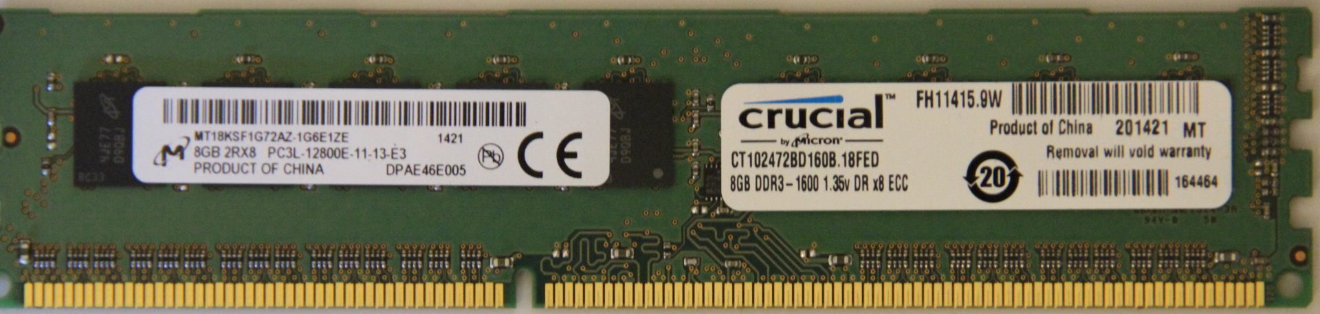

ZG says made in China, so I'll check mine and see what they say. @MichaelBatz - can you get us a picture of your DIMMs with the Micron sticker?
..and it just gets more complicated:
My DIMMs are MT18KSF1G72AZ-1G6E1ZE. Made in China, as well. Production date 21st week of 2014 (~late May).
The actual chips are labeled 4JE77 D9QBJ, same as a ZG DIMM.

MichaelBatz
Apr 30, 2015
26
Been a little busy the last couple of days.
(Forgot the production date. They are from 201441)
Thanks the replies everybody. I have decided to go along with my server as it currently is. I'll just have to watch it a little more closely, but that's okay!
The chips themselves seem to have the same label in E, F and G DIMMs.
So, there doesn't seem to be a physical difference between them.
