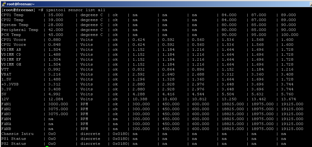

I attached a screenshot of the output of ipmtool sensor list all digited on my SuperServer 2027R-WRF.
Ericloewe, what do you think about ?
Tnx

View attachment 8753 I attached a screenshot of the output of ipmtool sensor list all digited on my SuperServer 2027R-WRF.
Tnx
The thresholds are really low for a server chassis - that wouldn't cause your trouble, but it makes your system less robust against fan failure.
At this point, my guess is either a fan that is intermittently blocked by a cable or something or a fan failing for some other intermittent reason. Your IPMI log should have some clues as to what's going on.
