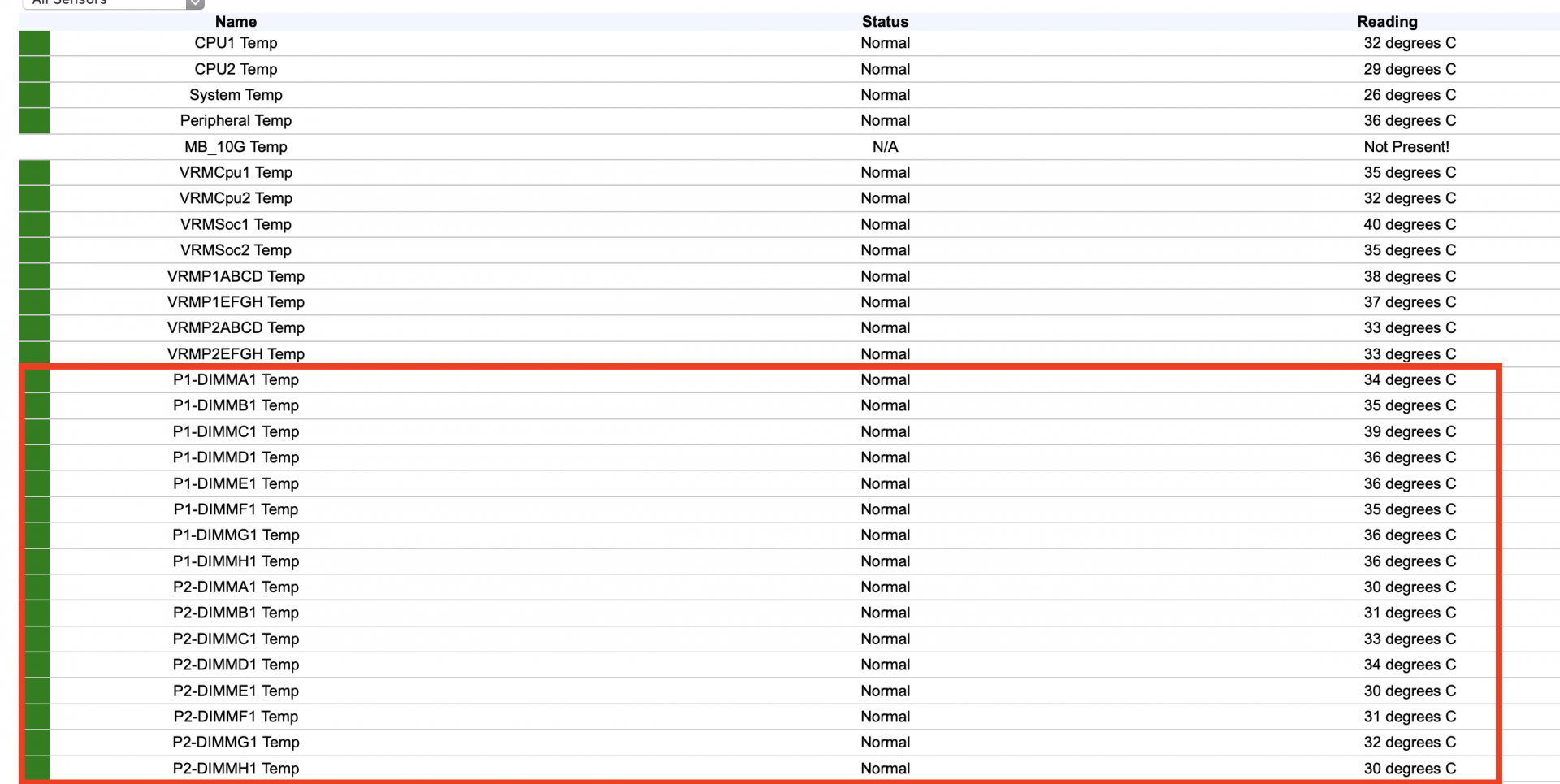

Hi guys,
I have a Supermicro H11DSi board (rev 1.0) with 2x Epyc 7551. I installed 16x Hynix ECC 128GB DDR4 LRDIMM 2666 modules. According to manual the rev 1.0 should handle 2TB memory and the rev 2.0 4TB.
But in IPMI "hardware information" menu it only sees 6 DIMMs = 768GB. When I go to sensor readings it correctly displays temperatures for all 16 modules.
Seriously, I'm losing my mind, the modules are exactly according to specs and yet only 6 out of 16 detected. It cost a lot of money and now maybe it was all thrown out of the window....

Well the fact that the DIMM's are seen over the system management bus isn't really that big a thing, it just means they're plugged in and powered on, and able to talk to the BMC subsystem. That's entirely different from being detected, configured, and usable by the main system.
What happens when eight modules are installed?

So IPMI reports temperatures for 16 DIMM modules but you're worried because the tree display shows only 6 modules. How much RAM is seen by TrueNAS? This, after all, is a TrueNAS forum, not a Supermicro forum.
Psynapsx
Oct 31, 2020
28
768GB reported by TrueNAS
