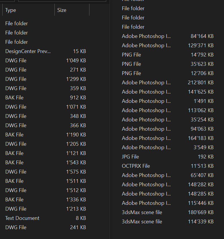

typical folder is looking like that, it's really mixed, doing 3d stuff, single files can to be larger (up to 2Gb):
As I understand MIRRORs are better in handling such data?
AND/BUT:
The plan to use snapshots will fragment the drive because of the releasing will force me to stick to that 50% rule for mirrors, right?
so: maybe I better stick with the spinning drives and get more raw space for the money.
