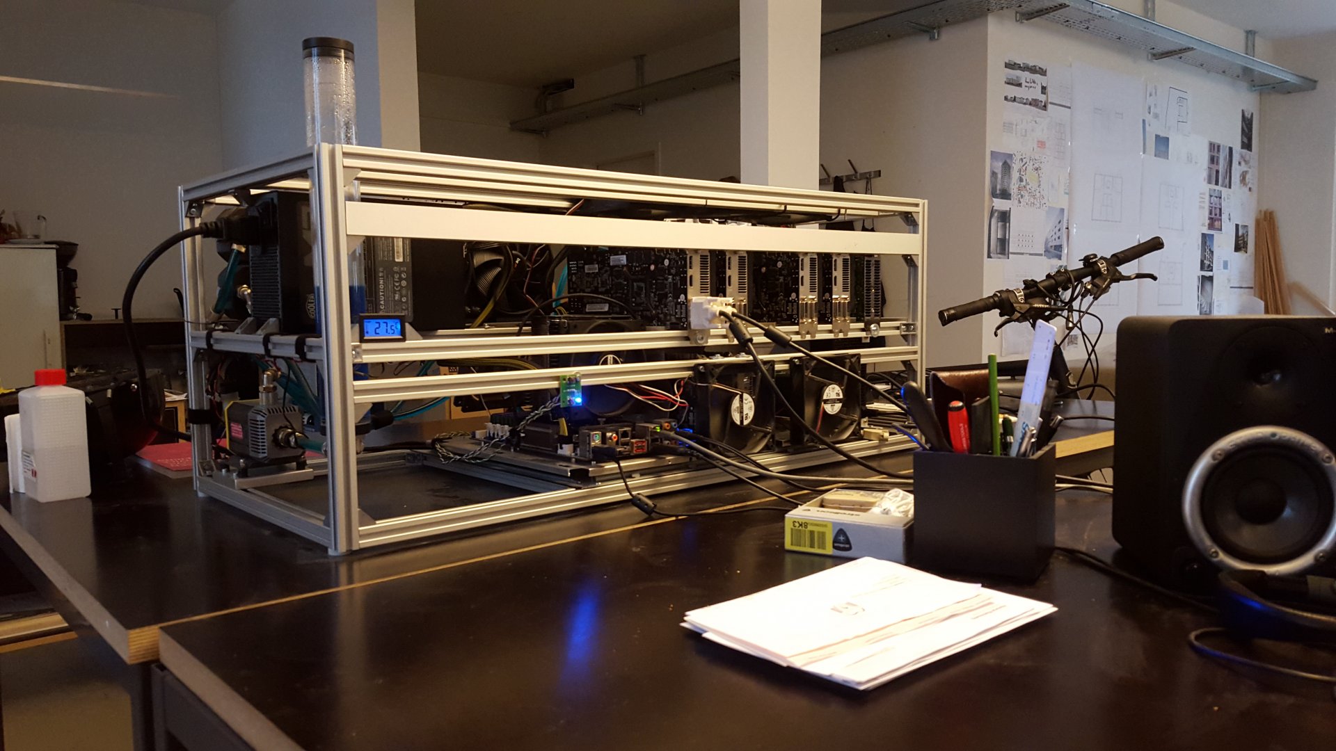

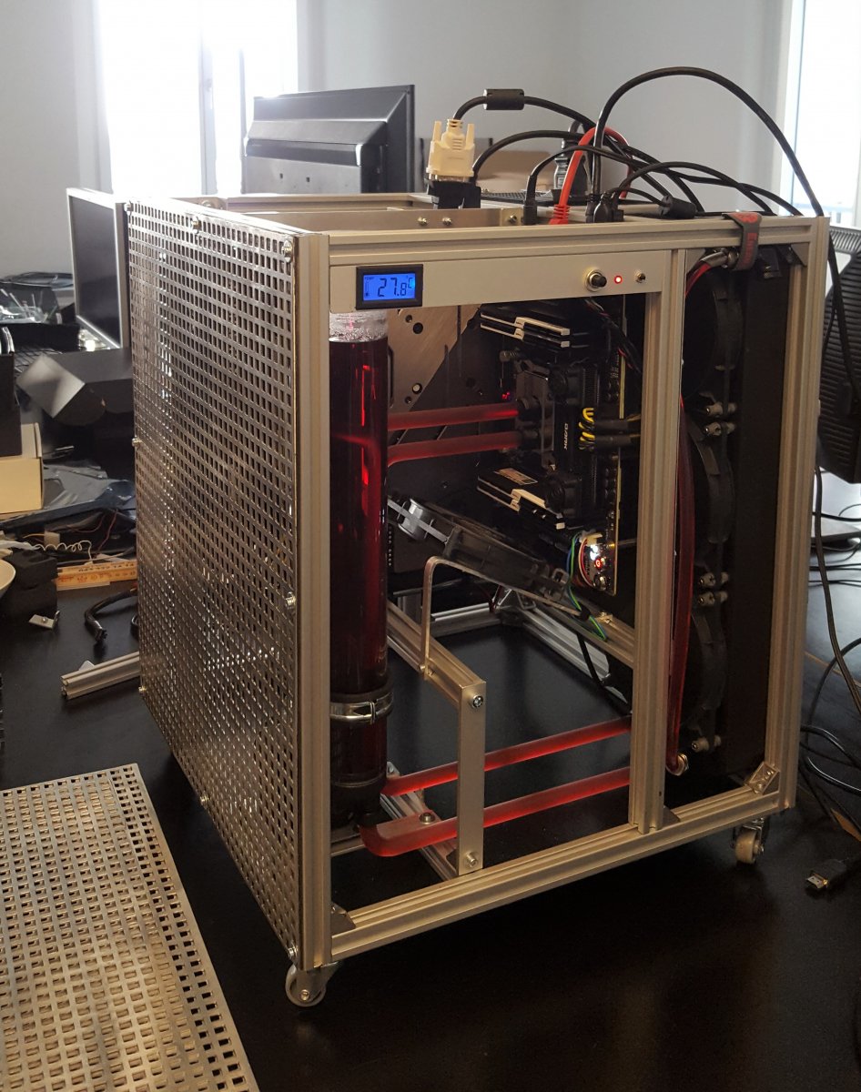

I am surely not a fanatic about energy consumtion:
This was my last workstation. 6 of the 7 gpus (2 are sitting directly on the MB) where basically idleing a good portion of the time.
I transformed it into that one a year ago, capable of holding 4 "airy" GPUs. Only the i9 9920X from silicon lottery is water cooled and slightely overclocked. You can't really hear the machine in an office environment:
