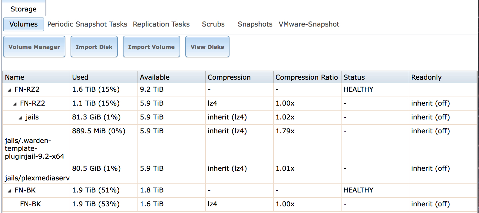

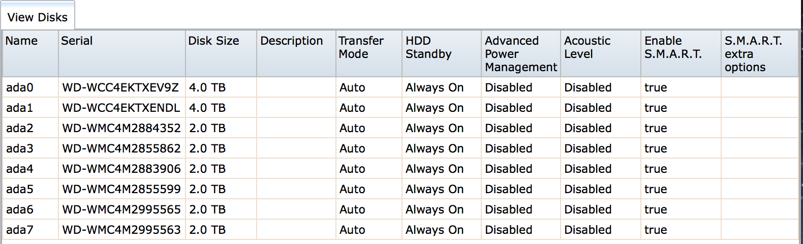

I've been running a FreeNAS-ZFS 24/7 home server for a couple years, adding/upgrading drives as required, which today consists of a pair of volumes: primary storage FN-RZ2 using RAIDZ2, and backup storage FN-BK as two mirrored drives. Pictures of my current HDD setup are attached.
All drives are WD-RED models. Backup is done nightly via rsync task in cron. This is primarily a Plex server, serving movies, music and photos to my home network. All of the media is separately backed up on an unpowered standalone USB HDD attached to my Mac desktop elsewhere on the network, so losing server data is undesirable mostly due to the nuisance of reconfiguring the Plex app and the time taken to reload the data files.
