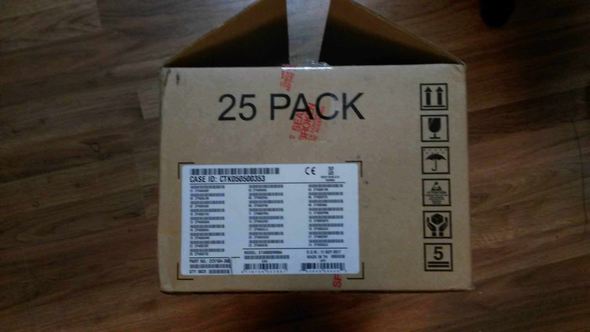

I replaced all of my drives in my two home NAS systems at the end of 2017 because of that failure rate increasing situation. It varies by manufacturer and model, but drives tend to fail more often around the five year mark and I had a quantity of drives that were all over five years such that I was having a failure (or two) every month.
I bought replacements:
Financially, it is probably better to replace then one or two at a time, but I was in a situation where I had two servers full of drives that were all about the same age.
