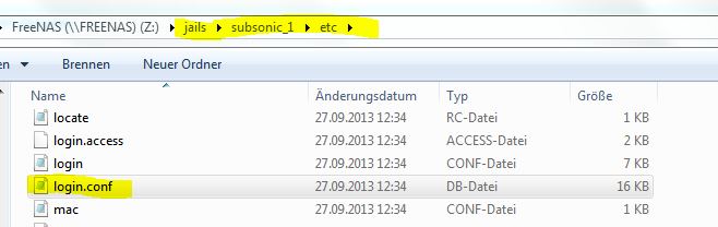

UPDATE:
I found another file and there I found these parts:
:charset=KOI8-R: :lang=ru_RU.KOI8-R:
(opened it with notepad and searched for "lang")
