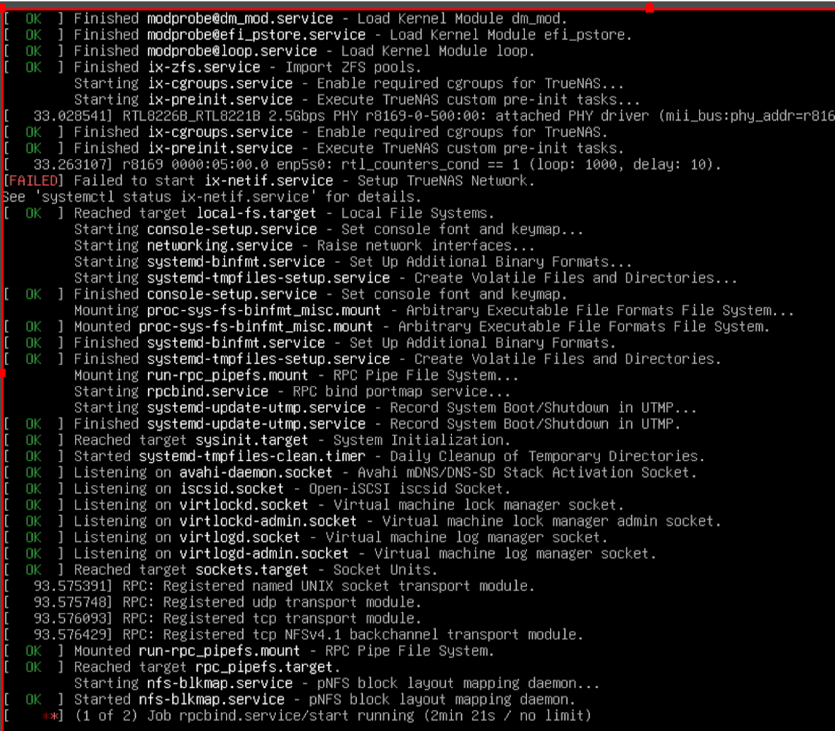

After I upgrade to 23.10.1 from 23.10.0.1, the startup stops at ix-zfs.service.
Does anyone know anything about this? Thanks!

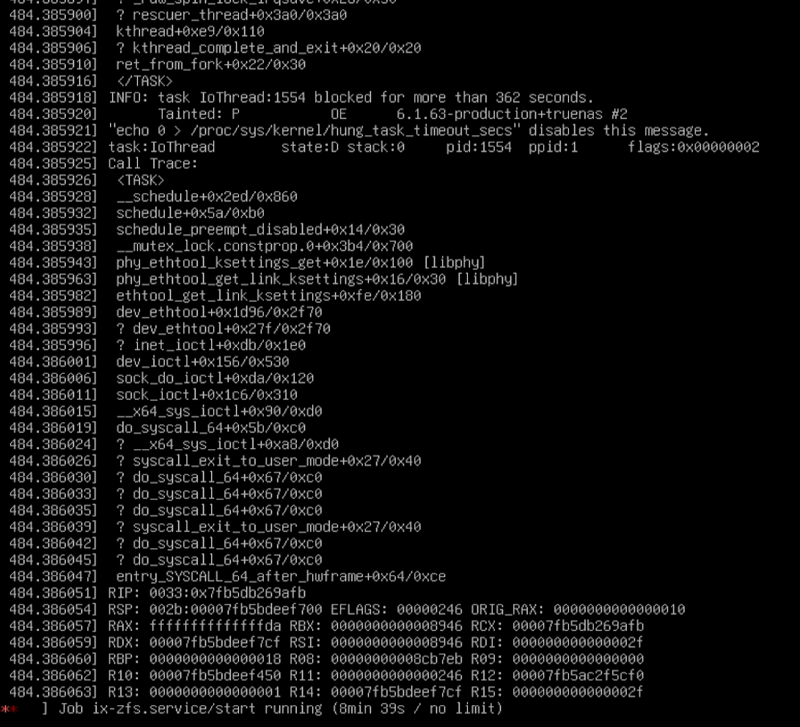

OneLastNAS
Sep 20, 2023
9
When I removed all HDD, it still can't boot.

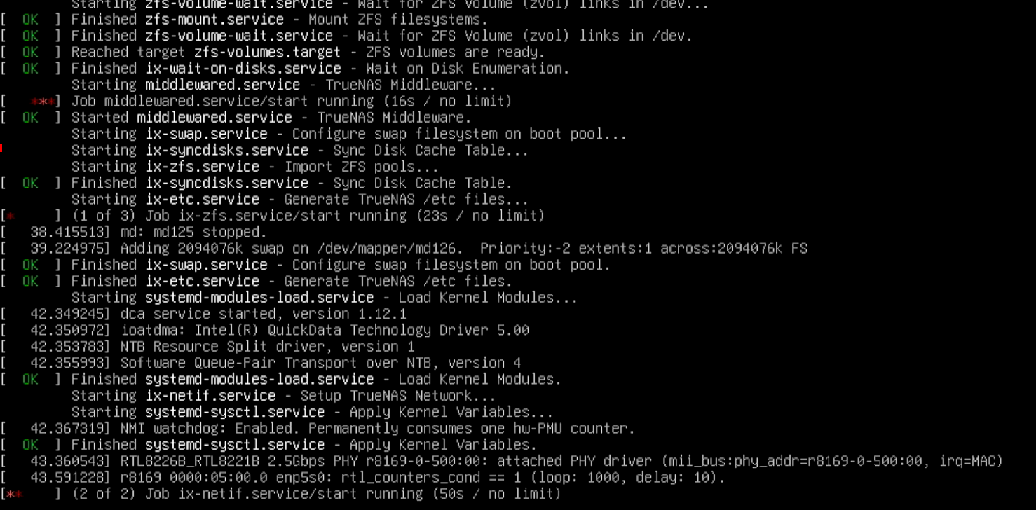

JumpMaster
Aug 26, 2023
Thanks for this! For me it fails unrecoverable after change the MTU on a bridged NIC to 9000. Boot takes 40+ minutes after several failures. Running most network commands fail. I am only able to roll back to 23.10.0.1, wipe the network config and perform a fresh upgrade. It does mean I can't use jumbo frames.
