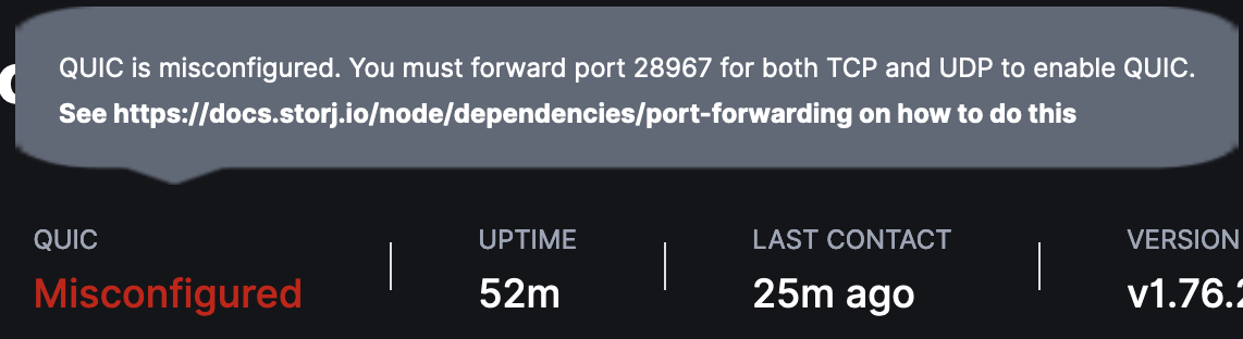

  • It defaults to port 20988 for the node, not 28967; the former won't work at all

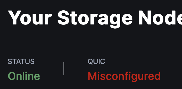

  • Even when set to use the correct port, it only opens it to TCP, not to UDP, and both are required. Otherwise, it gives this result:

Well, the app defaults to using TCP port 20988 (which the user can change at install time or later, but it's still a bad default), and no UDP ports (and there's no way for the user to specify additional ports that I can see). Storj wants both TCP and UDP (as correctly noted on the docs page, but not implemented in the app) on port 28967 (not 20988 as stated on the docs page). This is specified in their own docs, linked up-thread, and in the app's web console:
Apparently it's working without QUIC--it's using bandwidth, and storing data on my pool--but they're considering it misconfigured.
