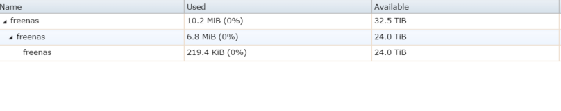

Question: the top freenas mount shows 32.5 TiB, a little high from past experiences but ok, however when i get down to the data drives it shows available of 24TiB - quite a loss, is this normal. Wanted to know before loading up with data, i will be moving close to 15 TiB almost immediately.

Yes, top row is in fact the pool so it shows the raw space (including parity, etc...) while the second row is the root dataset and shows the data space only.

Then it is normal for freenas to use that amount of space, 1/3 of the space, for recovery. if this is normal than i will start moving data.
15,504
It may be, or it may not be, depending on how you set up your pool. If (as would not be at all unusual) it's done as two RAIDZ2 vdevs, each with six drives in it, then 1/3 of the space is exactly what would be used for parity.

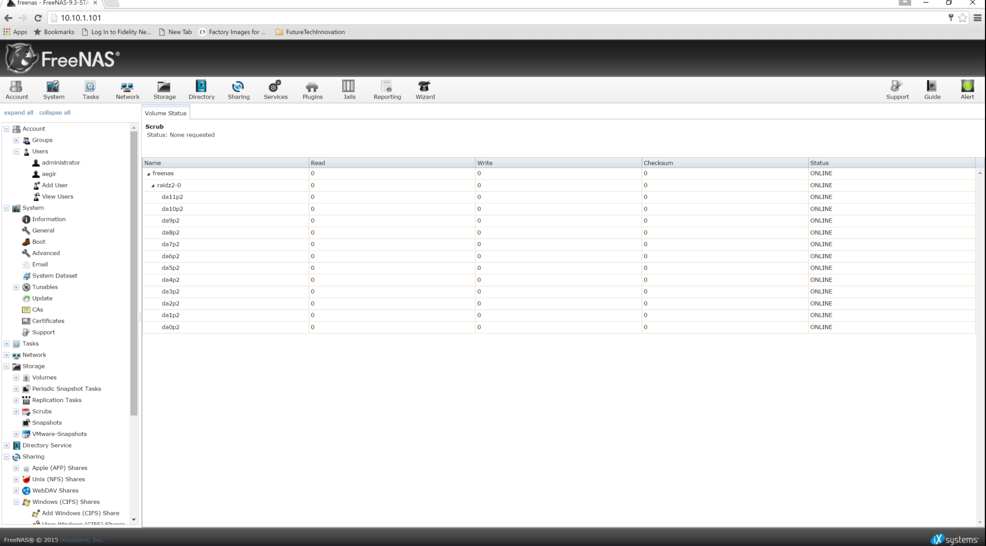

In the Storage tab, click on the top level of your pool, then click the Volume Status button at the bottom. Post a screenshot.
or
Run the zpool status command in a shell or via SSH and paste the results between CODE tags.
Roger Mahler
Jan 24, 2016
25
The following is the Volume Status you requested - thoughts

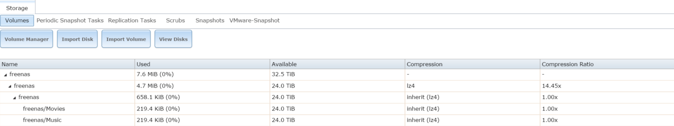

What i found odd was loosing so much memory, this is what i ended up with. Any help would be greatly appreciated - would like to have a little more storage available from the installed amount. Or have i really configured something incorrectly.

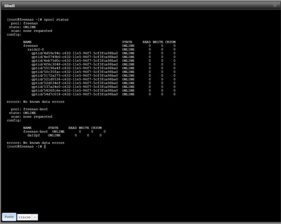

It is a little strange. It looks like that is an 11 drive raid-z2 (purely based on the space). Do you have a spare identified? Or is one drive a different size?
Mlovelace
Aug 19, 2014
1,111
Please post the zpool status output either from the shell or the GUI. No one can offer help if you don't provide the requested information.

there are 12X3TiB, 36 TiB in total. Attached is the zpool status, hope i got the right on this time.
and the storage volumes

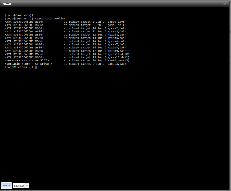

Can you also post the output of camcontrol devlist
Roger Mahler
Jan 24, 2016
25
Attached is the requested camcontrol devlist
jde
Aug 1, 2015
93
It looks like you have a sas expander between your drives and HBA. Please describe how you have the disk cabling setup. Also, post the output of "camcontrol identify /dev/ses0"
Do you have the LSI card flashed to IT model with updated firmware?
Is the firmware on the sas expander up to date?
