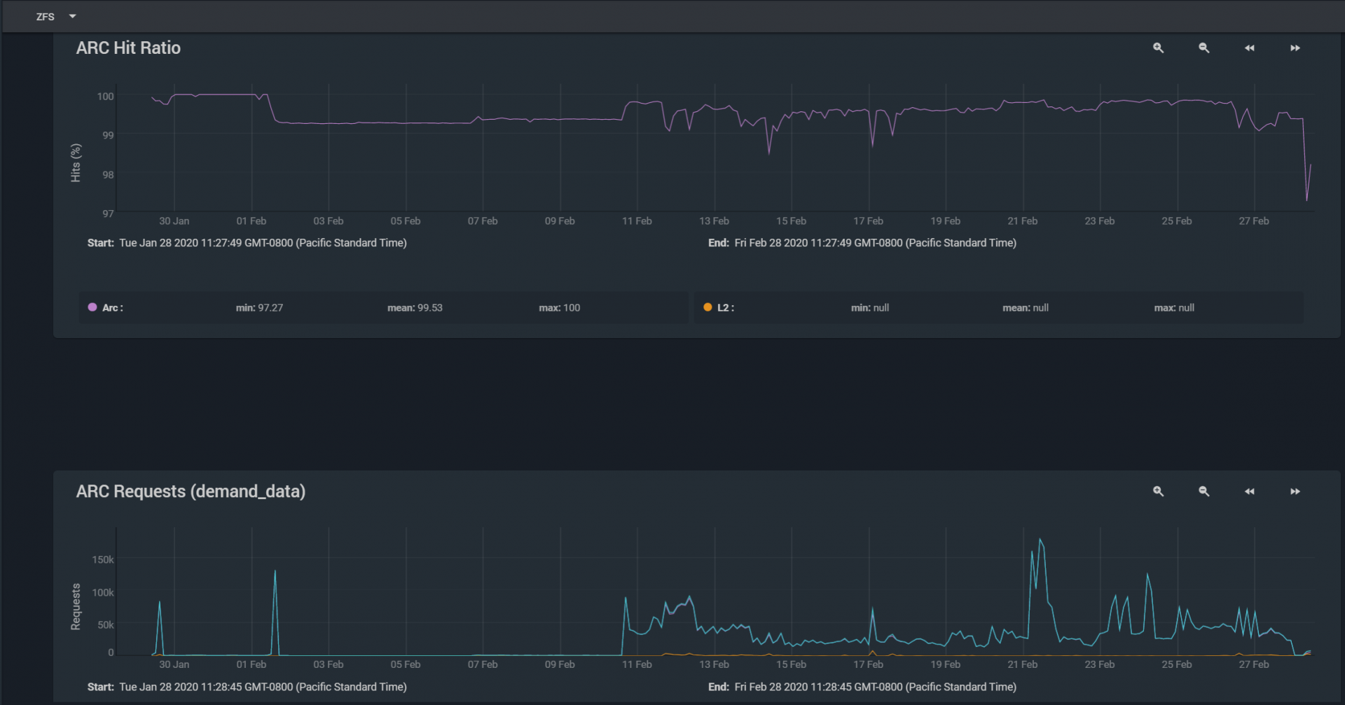

After a few weeks of running freenas I had a lok at ARC hit ratio.
Do I read this correctly, that L2ARC is not needed in my case?
JaimieV
Oct 12, 2012
742
Yes, no L2ARC needed. Your hit ratio is splendidly high. Congratulations!

L2ARC is even less necessary here because your pool is all-flash; to be beneficial, L2ARC has to be faster than your main pool.
