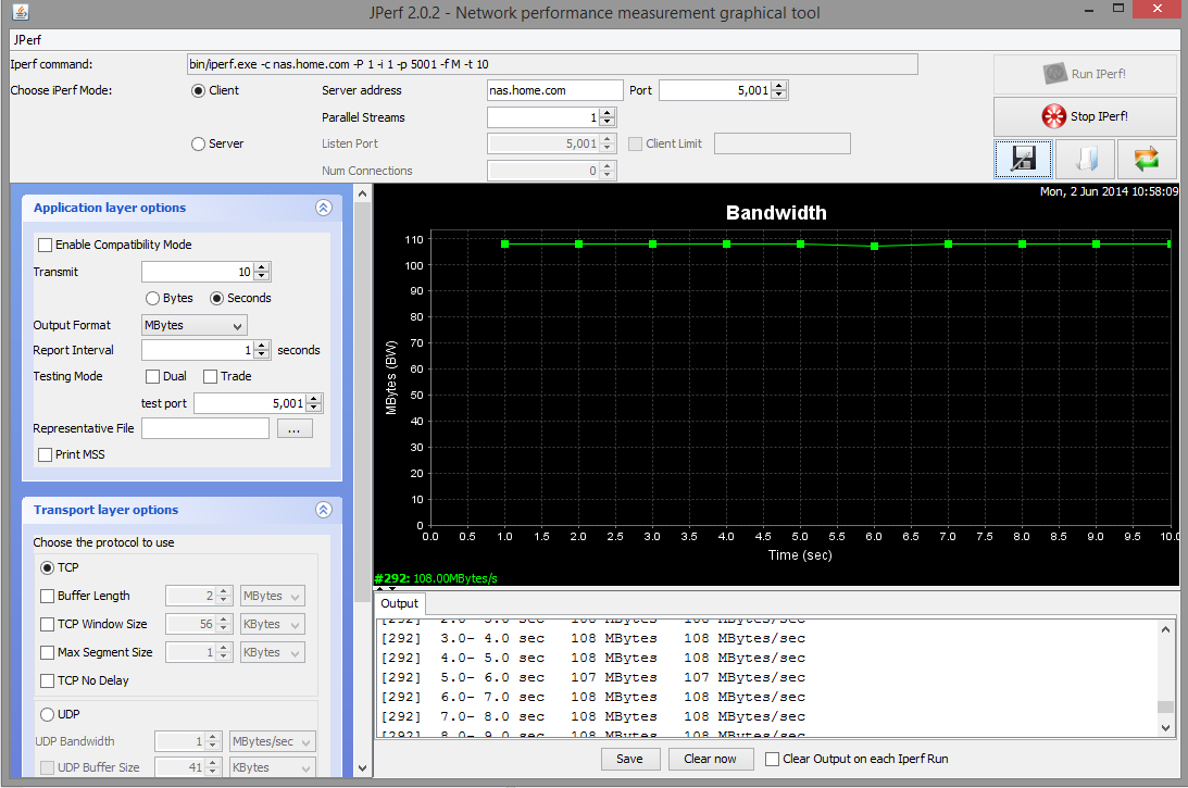

JPerf 2.0.2: 108 MBtypes/sec

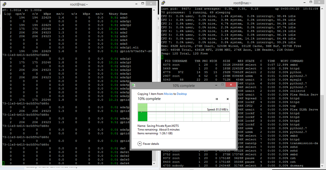

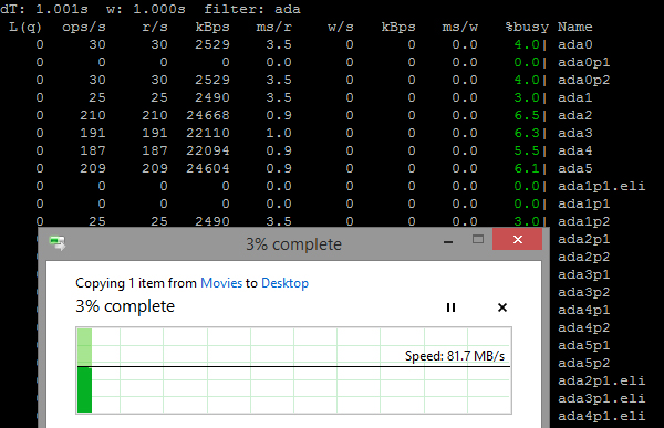

When I perform write tests or actually copy a file to the server gstat reports 50% to 100% %busy on all drives in the RAIDZ2. When I perform a read or copy a file from the server, gstat reports barely 10% %busy. I've attached screenshots for write and read above as a real-world example of my issue.

I appreciate your response. I have already verified everything on my network and my local machine. Also if you see the benchmark on the read speed that I provided, the text is from the actual FreeNAS server via SSH:
[root@nas] /mnt/MAINSTORE# dd bs=1024 if=testfile of=/dev/null count=1M
1048576+0 records in
1048576+0 records out
1073741824 bytes transferred in 10.946070 secs (98093821 bytes/sec)
This is showing only 98MB/sec on the server having nothing to do with the network or local machine. I have verified copying/writing files from several of my local machines at 110MB/sec as they are all very fast machines with SSDs. I am interested in advice as to how I should proceed with determining why the read speeds are so slow. Thanks again for your time.

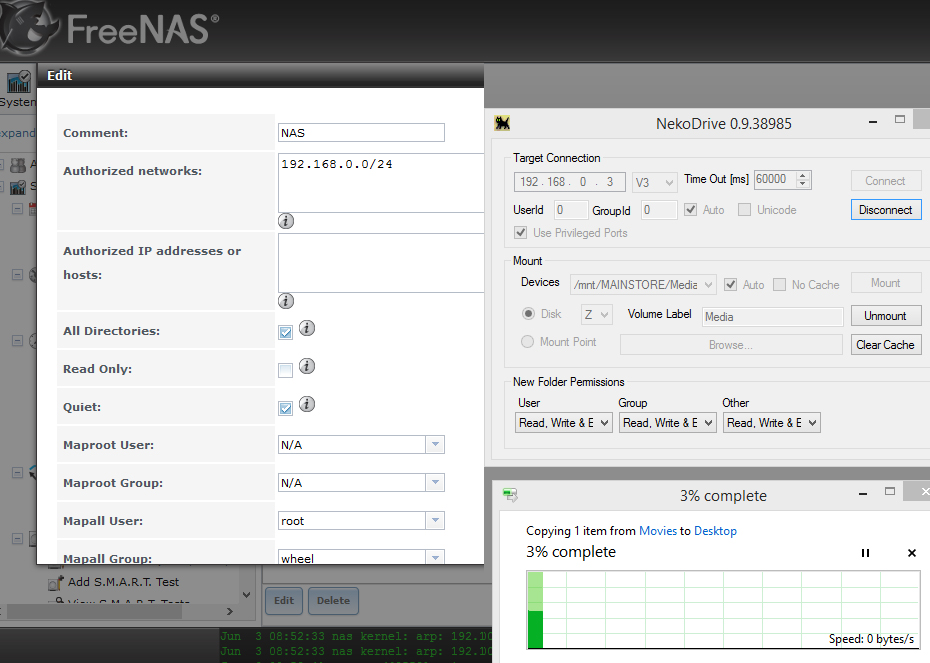

I'm attempting to switch to NFS but apparently you need Windows 8 enterprise for native support so I'm looking for a 3rd party software for this. As a side note, I had attempted reading using FTP with similar results at 85MB/sec. Slightly faster than CIFS.

NFS can be enabled on enterprise and ultimate versions of Win 7 & 8 . Or you can try using "Nekodrive".

The NFS with NekoDrive didn't work out well at all. It ran at 25MB/sec then kept stopping completely. I don't know if this gives you guys more info on what might be wrong but I'm stumped...

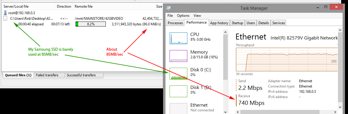

To eliminate NFS or CIFS from the equation, I tested using FTP and got the same results:

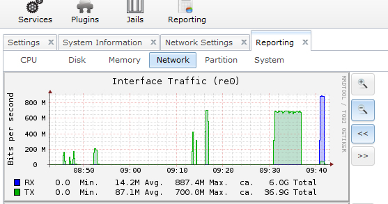

Lastly, here is a screen shot of a network report on the FreeNAS server of a file download vs an upload. It seems like the server can Receive 110MB/sec but only send 85MB/sec. Since I am 100% positive that it's not the test machine, what could be preventing FreeNAS from sending at the full 110MB/sec? The tests show that the pool is more than fast enough.

The test PC can read/write to another Windows 8 machine on the same local network at 110MB/sec. I've tested this right before I tested the read from the FreeNAS server.
I shutdown the FreeNAS for 5 minutes, started it up, and tried copying the file to my test PC again. This time I ran both gstat and top:
To eliminate any concerns about my internal network or my test PC (ROB-PC), here's a screenshot of me copying a file from another PC to it at 111MB/sec:

Eureka!!! You're right solarisguy it's the NIC! My first test was the server RECEIVING. This latest test is the server SENDING. Only 85MB/sec.
RealTek 8168/8111 B/C/CP/D/DP/E/F/G PCIe Gigabit Ethernet:
CONFIRMED NETWORK CARD ISSUE: RealTek 8168/8111 B/C/CP/D/DP/E/F/G PCIe Gigabit Ethernet
