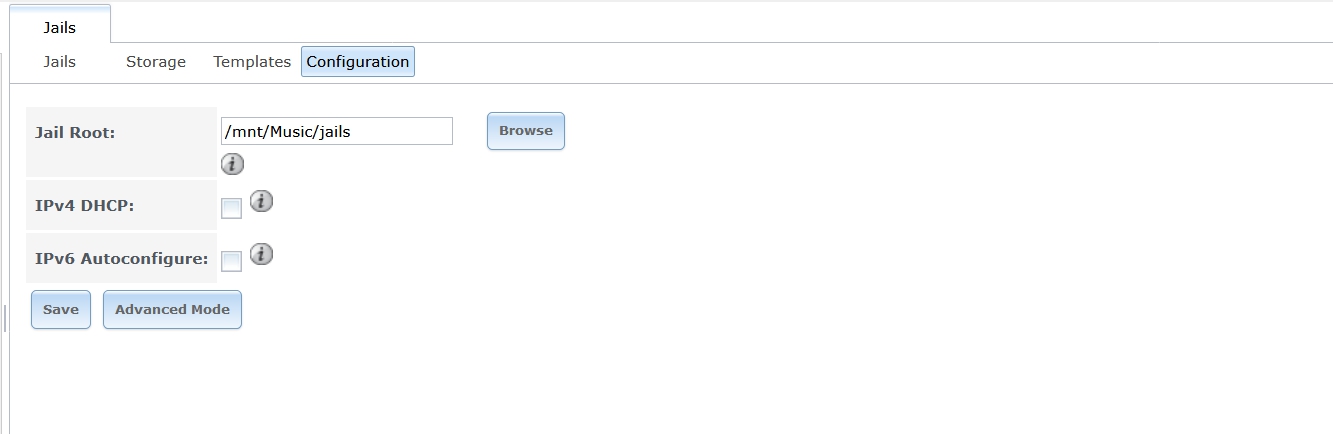

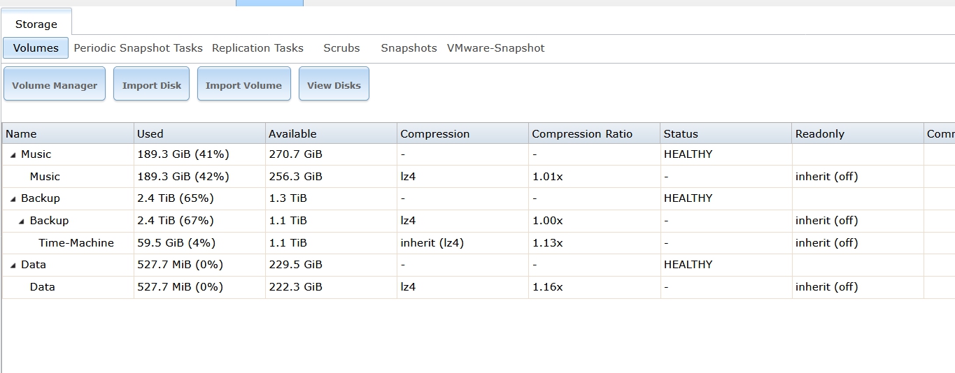

Its the only one I have attempted to install, although it is not there right now. Although the jail directory does not now exist, the Jail Root still shows .

I have 4 drives connected to the motherboard thus:-
SATA1:- FREENAS OS
SATA2:- Music Storage
SATA3:- Acronis Backups
SATA4:- Data
The jail root is on the Music Storage on SATA2. No matter what I try I can not change the root, so can I swap the Hard Drives around?

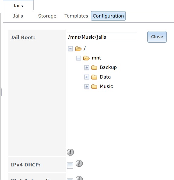

It doesn't matter what ports you hook your drives to FreeNAS will still recognize them as they are.
So if you hit the browse button to select the dataset where you want your jail root to be you can't select a different dataset? If so that's a bug and you should file a bug report.

I can browse for a new jail root
but the configuration will not 'stick' and goes back to where it was previously.
