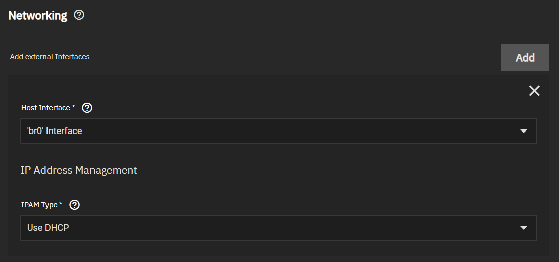

Solution 2: use DHCP and set the IP on the router.
The issue I have here is that the MAC address of the container is not static, so I need to change the DHCP configuration of the router every time the container restarts.
I can't find a way to use the --mac-address parameter via the Truenas interface.

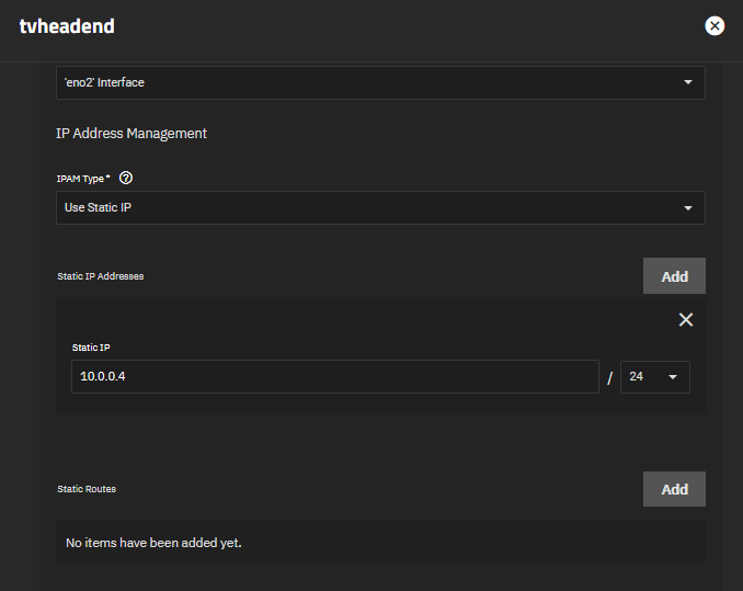

I'm not an expert on these things but i managed to assign a static IP to at least one app using your Solution #1 (Kind of).
These are my settings for TVHeadend which i have assigned the IP 10.0.0.4
I think that the main difference between your setup and mine is that you are using a "bridge" for your 2 NICS which i haven't done.
In my setup, the first NIC is used to access truenas. It is set as DHCP and i set an IP reservation for it on my router.
The second NIC is NOT set as either DHCP nor static IP. It is just there with a cable plugged into the switch. This allows me to use it as a dedicated NIC for apps.
While this solution worked for this particular app, i noticed it doesn't always work. For instance, webnut will not work with this solution.

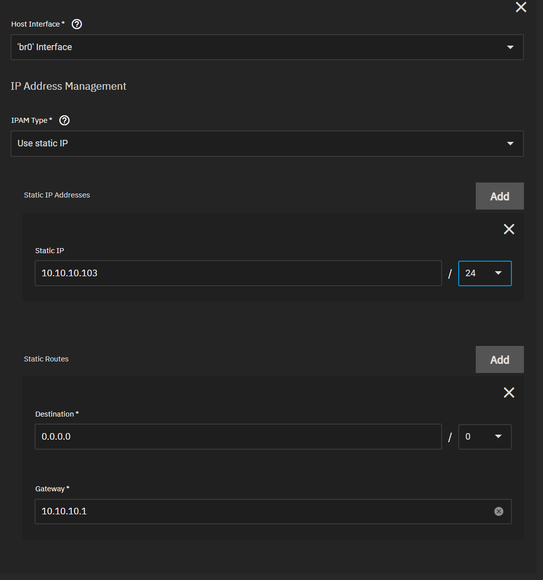

You can do that. Here's what I did, I made a bridge interface. Figure out how to make a bridge interface, useful for vms also, and assign the static IP to it on the launch docker screen instead of the nic, no need for aliases. Then assign static route, and a nameserver. I also changed the dns policy for my own reasons to kubernetes first but you shouldn't need to do that unless using kubernetes internal domain names.
You can't (as you found out) use --mac-address at this time in the UI. Therefore, DHCP doesn't work.
Static IPs for containers work great and can be used for many purposes. It also allows using any port number, so, < 9000, maybe the normal port(s) for the app. I don't bother with reverse proxies et al as there is no need, it runs just as if it was a unique machine. Uisng Emby, even dlna then works (without static IP dlna works only on the kubernetes network).
I used a few static IPs in my setup, for Emby, Nextcloud, Mariadb, and a VM. These services tend to work better on normal ports.

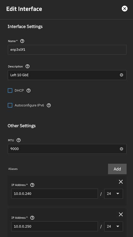

You can set two IPs
It appears to me you can set as many IPs as you want.
However I've found the following:
1. You need to bind the UI to one of those IPs, else it will bind to 0.0.0.0 and the TrueNAS UI will be available on all your IPs. Making ports 443 & 80 unavailable
2. If you use port 80/443 on one of your IPs, some apps still have conflicts. For example NGINX would not run on port 443 & 80 with the UI also running on those ports, regardless if I set the IP for both explicitly. I ended up using Traefik which will run on port 80/443 while the UI runs on 443/80 (you have to do the UI first, else it will complain about the ports already being used regardless if they are in use). Note that the IPs differ, I'm not an idiot.
3. You need to obviously use static IPs for the above.
Finally I'd forget about bridge adapters, I have 4 NICs, 2x 1 GbE and 2x 10 GbE, so I created a bridge adapter with all those interfaces together and set the IPs as you see above (ie. I can plug my cable into any of them and I should have the same IP). However it led to problems on startup, bunch of errors that the network isn't available, it appears that some apps will try to use the internet before the bridge is created. TrueNAS I would say doesn't really support bridge adapters, unless you are happy about errors each time you have a reboot. (I was not ok with that)
My suggestion is to bind your Apps to one IP and your UI to another IP then use a Traefik (Truecharts) on port 443/80. You can then create apps and use the ingress option. Using that option you don't need to expose the ports of those apps. (You would still need a DNS entry on your router for each FQDN pointing to the IP you assigned to your Apps).
Alternatively MetalLB (Truecharts) will actually allow you to assign an IP per app using layer 2 (ARP), but it works as a sort of DHCP of its own. You have to dedicate a part of your IP range on your DHCP service to your NAS and then allow your NAS to respond to those APR requests (ie who has 10.0.0.234? And your NAS would respond that it has that if you have an app running on that IP).
I personally found the MetalLB route too hacky for my taste, YMMV.

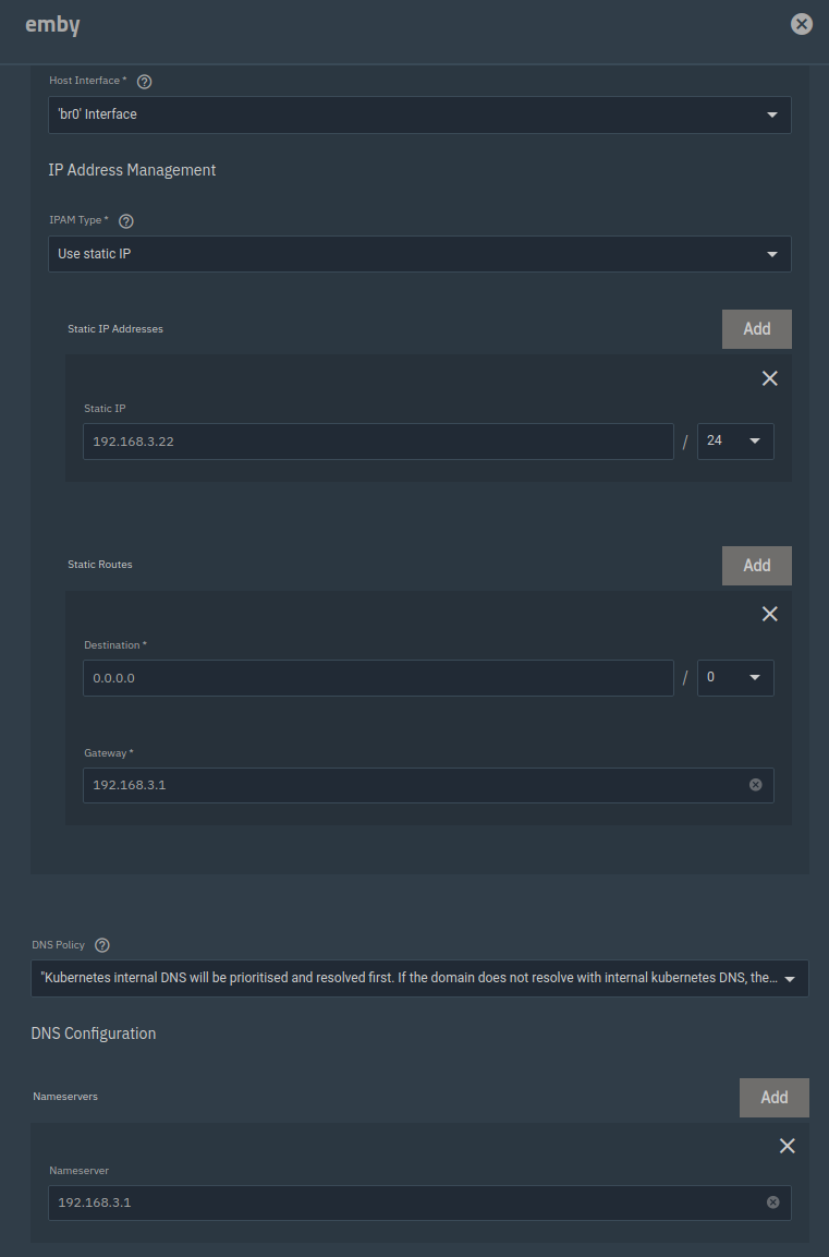

Here's my Emby network settings (Emby using docker not APP from IX or Truecharts):
