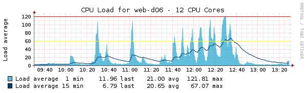

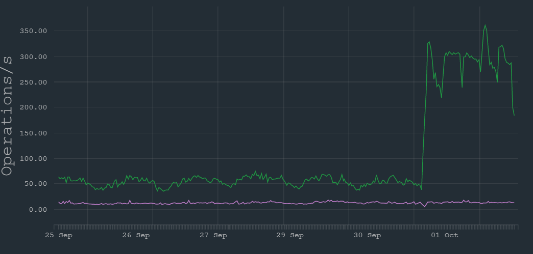

OK so having scrub_delay set to 4 was fine for the most part but we were seeing unexpected periods of extremely high latency on the web servers (Apache/PHP serving files from the FreeNAS server) so I increased it to 8. This is the impact that change had. You can see how the load had been low aside from a few spikes, but then for some reason it steadily increased to over 100 until I increased scrub_delay to 8 (where the load drops off):
The spikes appear to be directly related to the scrub. If I pause it, the load immediately goes down. Nothing else is running at this time and web server traffic is what it normally is.

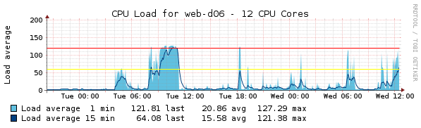

Here you can see when the scrub starts and the impact this had. The beginning of the scrub is where scrub_delay appears to be getting completely ignored:
Tuesday at 4am EST is when the scrub started and caused load to climb to > 100 which took the site down. Here's a corresponding IO graph for one of the data disks:

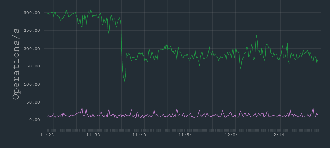

And this is when I set scrub_delay to 8:
Nothing too surprising here I guess, but what I don't get is why latency is spiking when IO is always around 300ish with scrub_delay set to 4. I would expect IO to be lower when latency is low and topping out at 300ish when it's high, but that doesn't appear to be the case.
It's as if the scrub starves the disks of IO over time. Setting it to 8 seems to be working well for now though so I'll leave it at that (but I wouldn't be surprised if latency spikes again).
