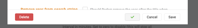

Restart the jail, the error will still show when you access the System Status inside Radarr UI. You need to test and save each indexer configuration in Settings > Indexers, then the error will be gone:
