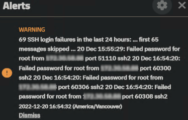

SSH Login failures in the last 24 hours. Prohibit root password
Dec 18, 2022
13

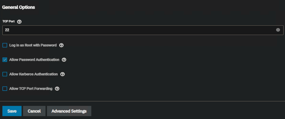

Hello,
I am wondering if I can some how "disable password" for root, but not for others.
I mean set it with a reply to clients "root@server: Permission denied (publickey)".
Technically password for root is disabled. I use public key for this account, but if I login it will ask for a password.
It will not be accepted even if type a correct one.
In my company where I am at the moment we have our internal network scanned and tested for weak root passwords.
So I keep seeing this message in TrueNAS Scale 22.12.0.

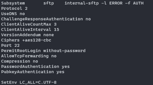

My configuration
If it would be a manual configuration I would set it to "PermitRootLogin prohibit-password" instead of "PermitRootLogin without-password"
So is there a proper way to configure it?

I see, then there is nothing you can do to prohibit the port scan messages you see in UI. You were talking about performing a sed into /etc/ssh/sshd_config, which will not do anything to your port scanner messages and also revert back to previous value after reboot. See public release changes for PermitRootLogin, without-password and prohibit-password is the same thing.
* The default for the sshd_config(5) PermitRootLogin option has
changed from "yes" to "prohibit-password".
* PermitRootLogin=without-password/prohibit-password now bans all
interactive authentication methods, allowing only public-key,
hostbased and GSSAPI authentication (previously it permitted
keyboard-interactive and password-less authentication if those
were enabled).

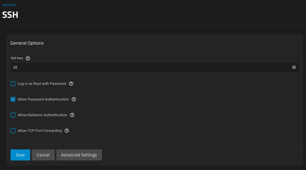

in your SSH service config you can control users.
editing config files on truenas is usually a recipe for the settings to go away on an upgrade.
Auxiliary Parameters
MaxAuthTries 6
MaxSessions 10
PubkeyAuthentication yes
PermitEmptyPasswords no
PasswordAuthentication no
Match user root
PubkeyAuthentication no
