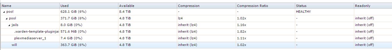

@danb35, attached is an image of my current volumes/datasets. Is all I need to do is click the "Create a new dataset" button, give it a name, and that is it? I was looking at the documentation on FreeNAS, and there isn't a ton of guidance. I am just a little confused about what the new dataset, in theory, is providing. Thank you!
15,504
Click on the second entry for "pool", then click the create dataset button. Give it a name, make sure the permissions are set to Unix, and you're good. What it is providing is a part of your pool that is not using Windows permissions, which is (most likely) what's preventing you from setting the proper permissions on the authorized_keys file, and thus from logging using SSH keys.
