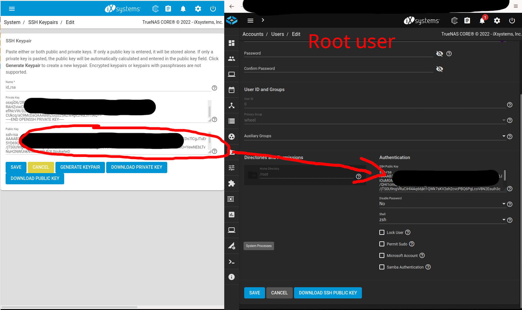

I was having this issue as well and I finally figured out my solution, not sure if this is your issue, but maybe this will help anyone viewing this thread in the future.
In sum, the ssh key pair on the client system must correspond to root's public key on the remote system.
Make sure the SSH Connection you setup uses that SSH Keypair.
I mistakenly thought the key pairs needed to be the same on both systems in the System > SSH Kepairs section in the GUI. TrueNAS-12.0-U8
SSH TrueNAS documentation
